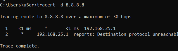

I connected pc to rujie RG-EG105G and is providing IP to my pc, but the above error message is shown. Any solution?

From the above screenshot, the PC accesses 8.8.8.8 and the data is lost when it reaches EG
1. Check whether the EG is connected to the Internet
2. Can you provide me with the configuration of WAN port and LAN port, my email is wangyang11@ruijie.com.cn
3. Can we make an appointment for remote inspection?

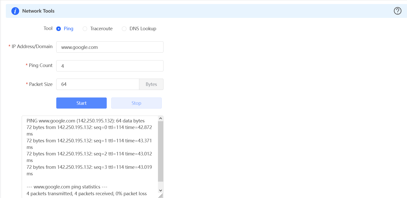

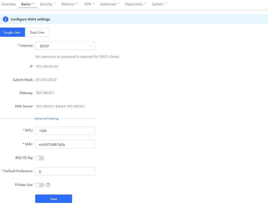

The internet connectivity is provided to EG from internet.

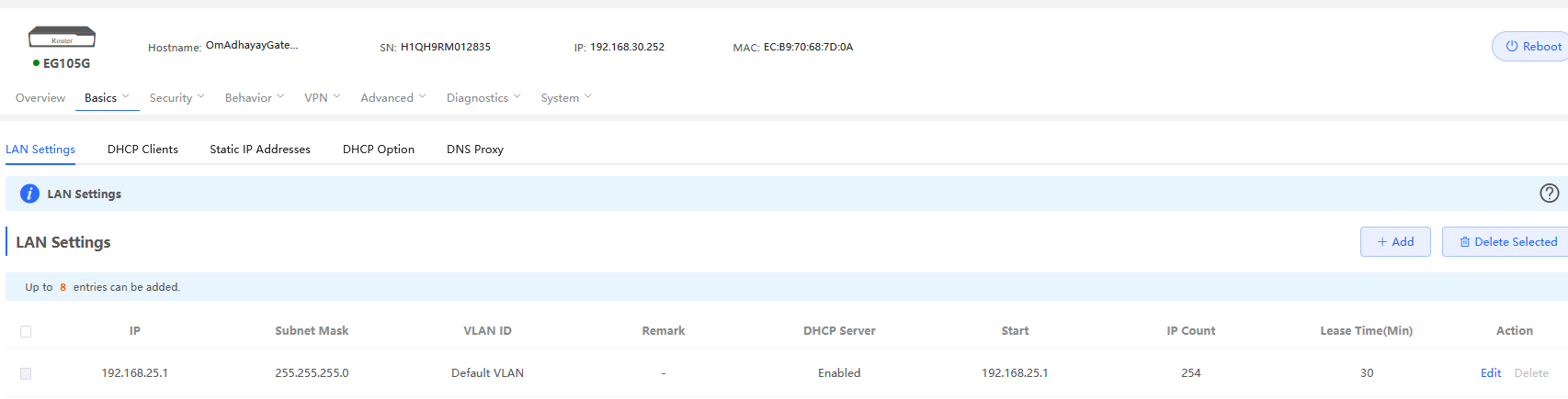

WAN interface above:
LAN interface above
Well, the location is Nepal, so it might be hard for you to remote inspection
