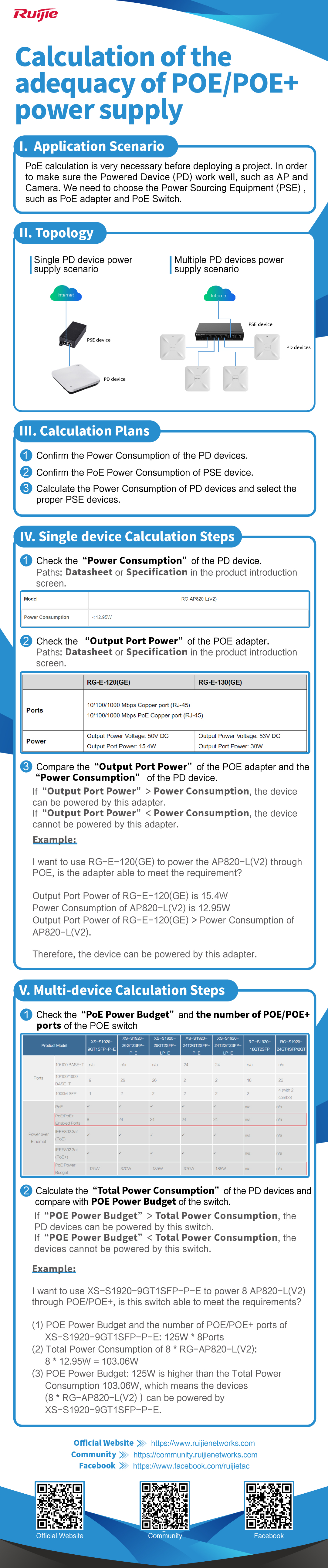

Calculation of the adequacy of POE/POE+ power supply Reply

Jacob Hue replied at 2022-7-29 00:50
In order to be able to use a product, the user needs to have enough power. Power supply is a crucial ...
isn't all the ES200 series and above switches are already POE+ which is 30W per port max?
However, the maximum POE budget of the switch is significantly lower than 30W multiply by the ports.
For example, ES209GC-P & ES209C-P can only deliver 120W maximum POE budget. If i have high power POE devices that can use up to 24W per port, I can only use maximum 5 ports instead of 8. Why is the design like this? So forever we won't be able to get enough power, although i dun see any AP that can constantly use up more than 10W power yet. Even the EW-3200GX Pro is designed to run at 24W max.
