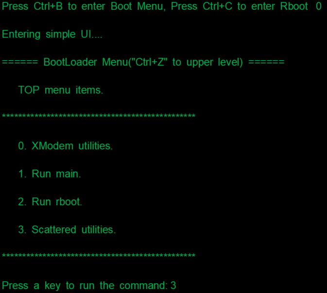

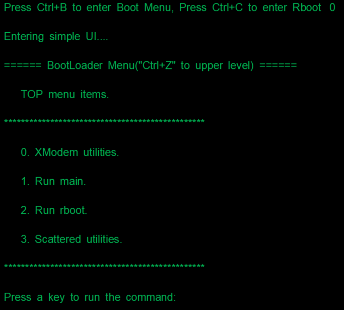

2. Manually reboot the switch,When you see the Ctrl+B prompt, press Ctrl+B continuously to enter the boot screen.

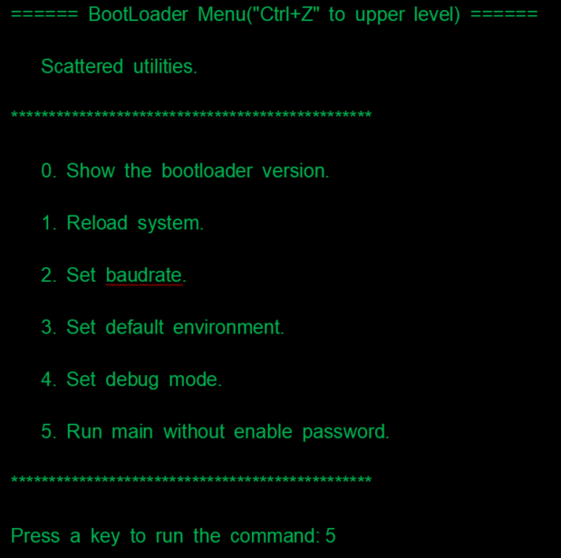

3.Select 3 to go to the Scattered utilities menu.
4.Select 5 to Run main  without enable password.

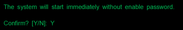

5.After selecting Y, the device will automatically reboot.
After rebooting, you can log in to the device without enabling the password and the configuration will not be lost!

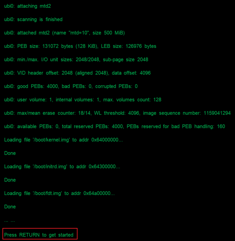

6.When you see "Press RETURN to get started", you can log in to the device without  enabling the password.

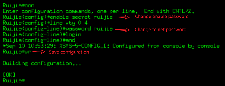

7.After entering the system without enabling password, you can view the original username and password; if the original password is encrypted, you can choose to modify the new username and password.
