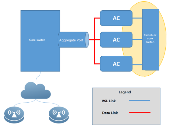

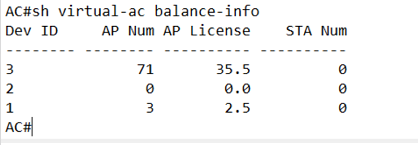

Problem Description:
There are three ACs on a VAC, but APs are all connected to one of the AC.
Topology:
Troubleshooting Step:

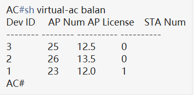

Verification:
After setting, APs load balance successfully
, you can see the following result:
