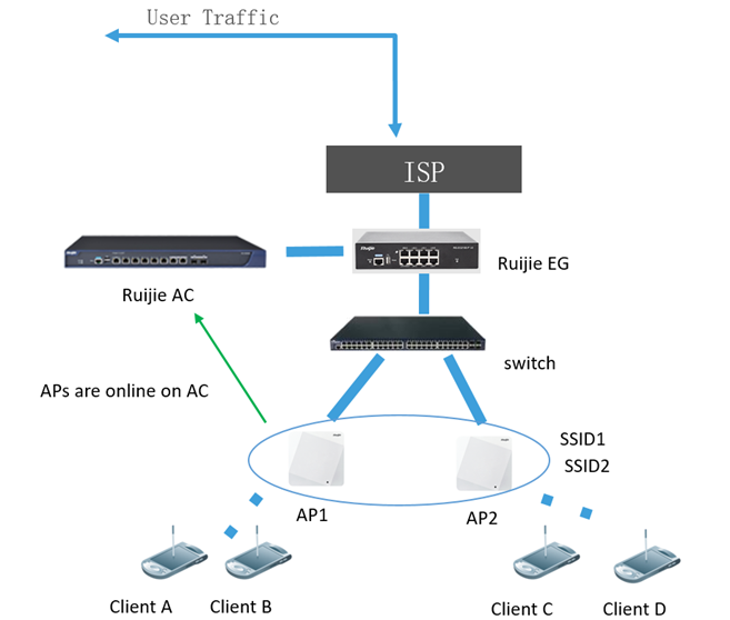

When the capwap tunnel of the AP is disconnected, the AP will release an unencrypted 2.4G SSID to let wireless clients connect, when the capwap tunnel is established, this SSID need to be closed.
Applied scenarios

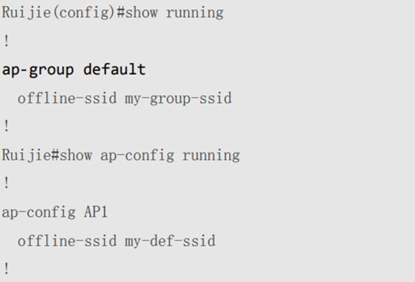

Verification
Check the configuration through ‘show running ’ and ‘show ap-config running’ command.
If the APs were offline from AC, the AP will broadcast the SSID '
my-group-ssid
' to let wireless clients connect.
