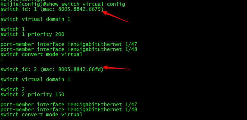

When the VSU deployment is completed, which interfaces in the configuration acts as VSL links? Reply
GTAC-Eureka
4698 0 2022-6-1 19:11:07
1. View the VSU configuration with command 'show switch virtual config', you can see the VSL link of the switch.As shown in the below:  the interface TenGigabiEthernet 1/47 and 1/48 are used as VSL links

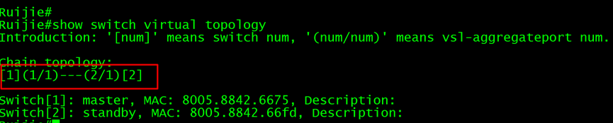

2. According to 'show Switch virtual topology‘, you can know that 1/47 is connected to 1/47 of the opposite end, not 1/48.
example:[1](1/1) [1] means switch id, (1/1),the first 1 represents the switch id, and the second 1 represents the first interface of the aggregation interface
