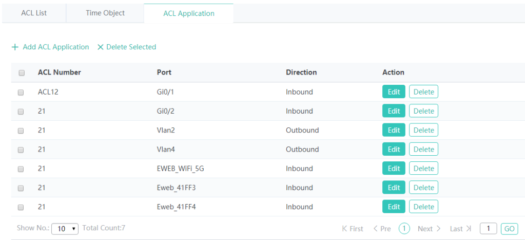

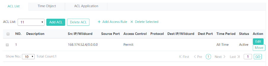

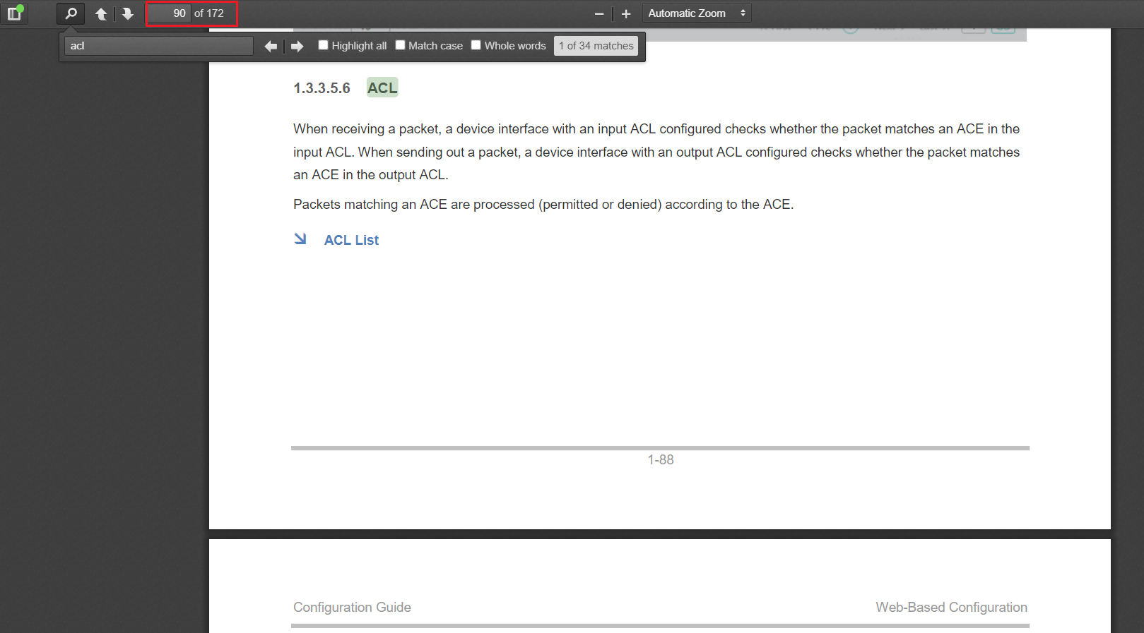

You may refer the 90th page of  AC Web-based Configuration Guide to configure ACL on WS6008 eweb.
https://www.ruijienetworks.com/resources/preview/75258?t=637898005260608750
You can check the ACL entry in ACL list and ACL Application menu.
