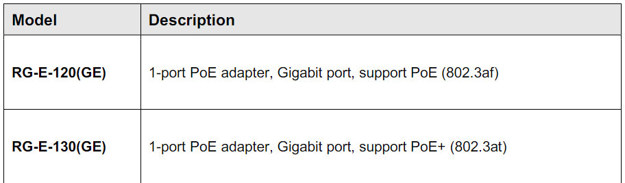

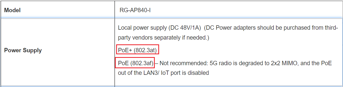

Shown as the spec of AP840, its power supply is the PoE and the recommended PoE+.
So, it allows RG-E-120(GE) and RG-E-130(GE) as the power supplier, and the RG-E-130(GE) is the recommended one.
