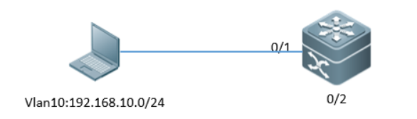

Networking Requirements
The users in the 192.168.10.0/24 network segment can access to local switch by telnet.
Network Topology
Configuration Points
1.Before configuring the following steps, please make sure that you can access to the switch by telnet and SSH normally.
2. Configure ACL
3. Apply ACL under VTY interface
Configuration Steps
Step1: Configure ACL
Ruijie>en
Ruijie#config ter
Ruijie(config)#ip access-list extended 100
Ruijie(config-ext-nacl)#5 permit ip 192.168.10.0 0.0.0.255 any----->Only the administrator network segment is allowed to access the switch
Ruijie(config-ext-nacl)#exit
Step2: Apply ACL under vty interface
Ruijie(config)#line vty 0 4
Ruijie(config-line)#login
Ruijie(config-line)#password ruijie
Ruijie(config-line)#access-class 100 in
Step3: Save running-configuration
Ruijie(config-line)#end
Ruijie#write----->Ensure that the configuration is correct and save the configuration
