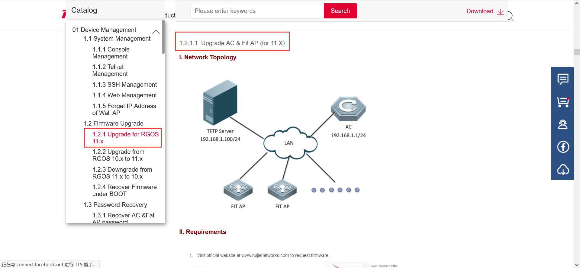

How can I upgrade FIT AP firmware?
5387 0 2022-6-10 10:00:29
You can batch upgrade the AP firmware on AC by following this guide on page 18:
https://www.ruijienetworks.com/support/documents/slide_75752
