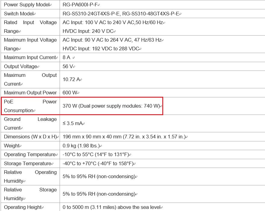

Does RG-S5310-48GT4XS-P-E support 2 power modules? Reply
3772 0 2022-6-12 23:26:38
Yes, the switch can be powered on by either one power supply module or dual power supply modules. If both power supply modules are used, the switch works in the power redundancy mode.
