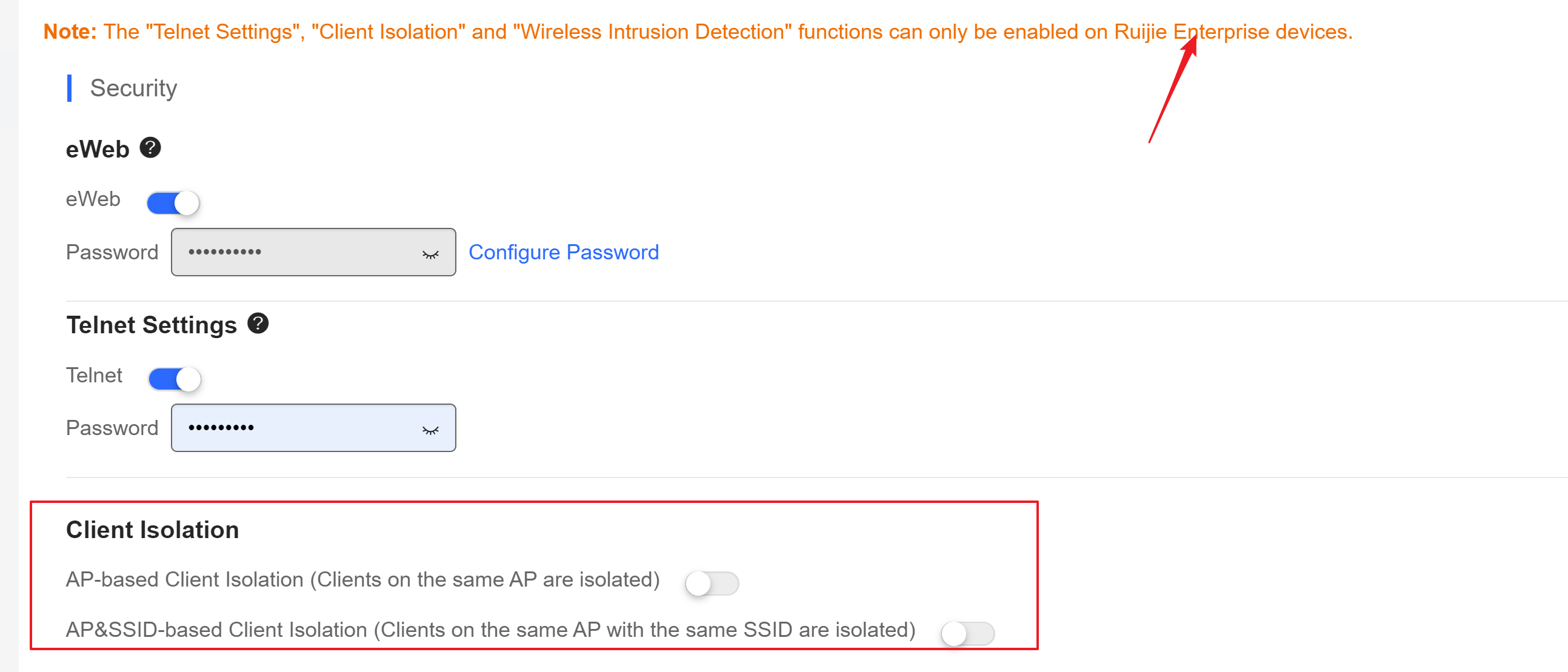

Dear Sir
do you mean how to configure client isolation based on SSID
it's only support ruijie device,if you want to do client isolation,you need to login device web interface,
best regards
Sam

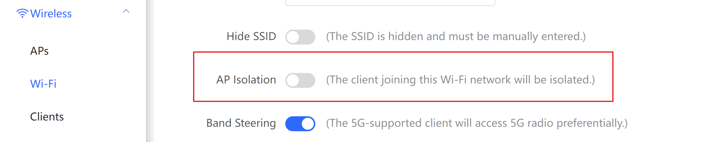

If you were to do this, wouldn't all clients under that SSID of the AP become isolated?
can't we choose which SSID to have client isolation?

There are two types of wireless user isolation: AP-based user isolation and AP-SSID-based user isolation and all the SSIDs of the AP will become isolated. You may follow this guide to configure it: https://community.ruijienetworks.com/forum.php?mod=viewthread&tid=3554
. Sorry for the inconvenience.
