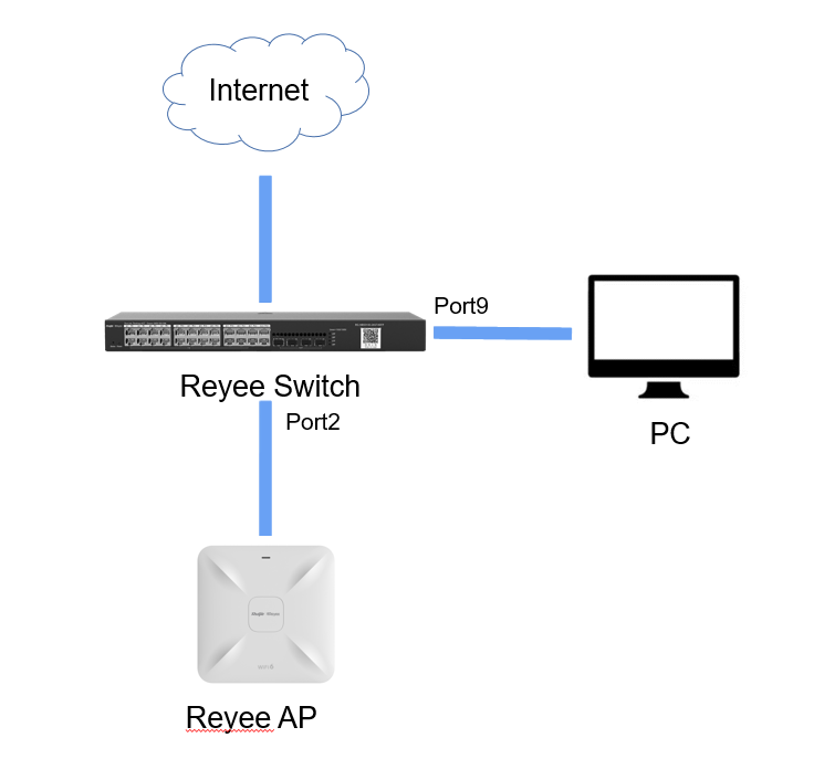

Topology
Requirement
Capture the packet between switch and AP
Steps
1. Download and install Wireshark on the computer for packets capturing, and connect PC to Reyee switch's port 2.

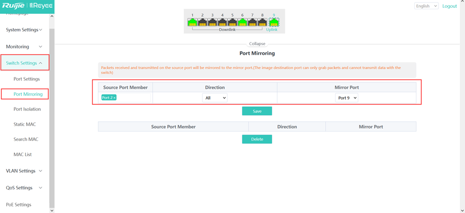

2. Configure port mirror on switch, so that PC can capture the  packet  of port 9.
For ES series switches, you can click Switch Settings > Port Mirroring, select the source port, direction(Input/Output/All), mirror port for port mirroring configuration and click Save.You can change the port based on your situation.

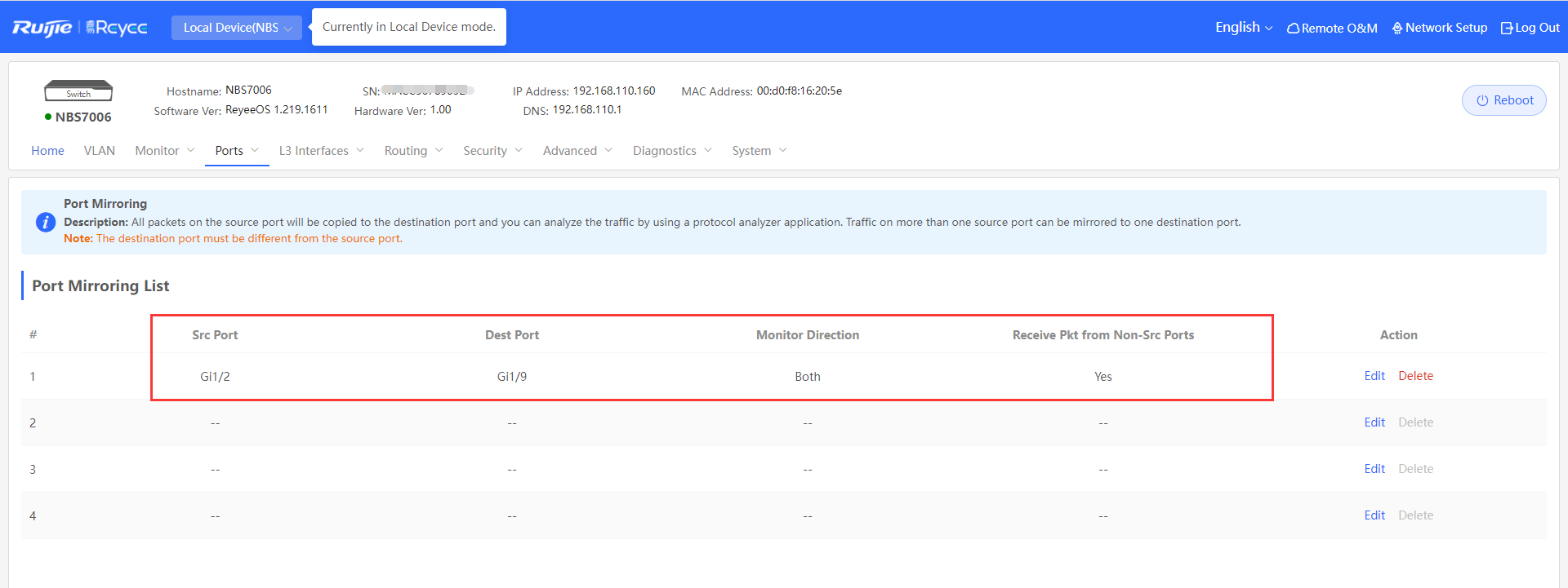

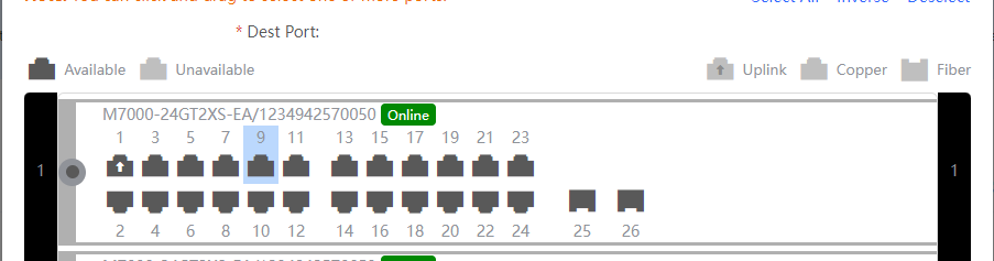

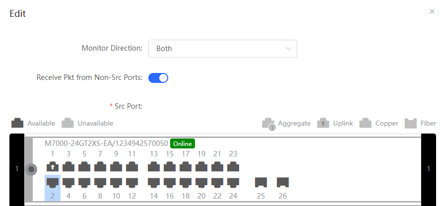

For NBS series switches, you can select Switches> Ports > Port Mirroring > Edit. In the displayed dialog box, set the source port, destination port, and monitoring type, and click OK.
Note: A maximum of four port mirroring entries can be configured. Port mirroring cannot be configured for ports that arealready mirrored.

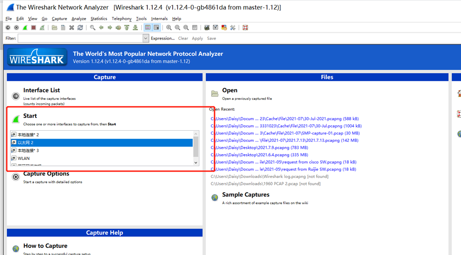

3. Run Wireshark, double-click the network Interface connecting to the device
4. Save the packet.
