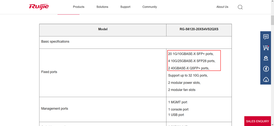

What does 'support up to 32 10G ports' mean in RG-S6120-20XS4VS2QXS description? Reply
3694 0 2022-6-14 10:32:00
Because 40G QSFP+ports of RG-S6120-20XS4VS2QXS support both 40G mode and 4x10G mode, if working on 4×10G mode, 2 40G ports canbe splited into 8 10G ports, so if we use all ports for 10G, total is 32 10G ports.
