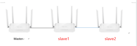

If I do three-lay mesh scenario on EW devices, can slave 2 mesh with slave 1? Reply
GTAC-Eureka
4278 0 2022-6-21 14:50:14
Slave devices can only mesh with the master device. It is recommended to let slave 2 and master mesh successfully first, and then put slave 2 in the correct position. At this time, slave 2 doesn't need to mesh again, and it will automatically select the device with the strong signal to do mesh.
