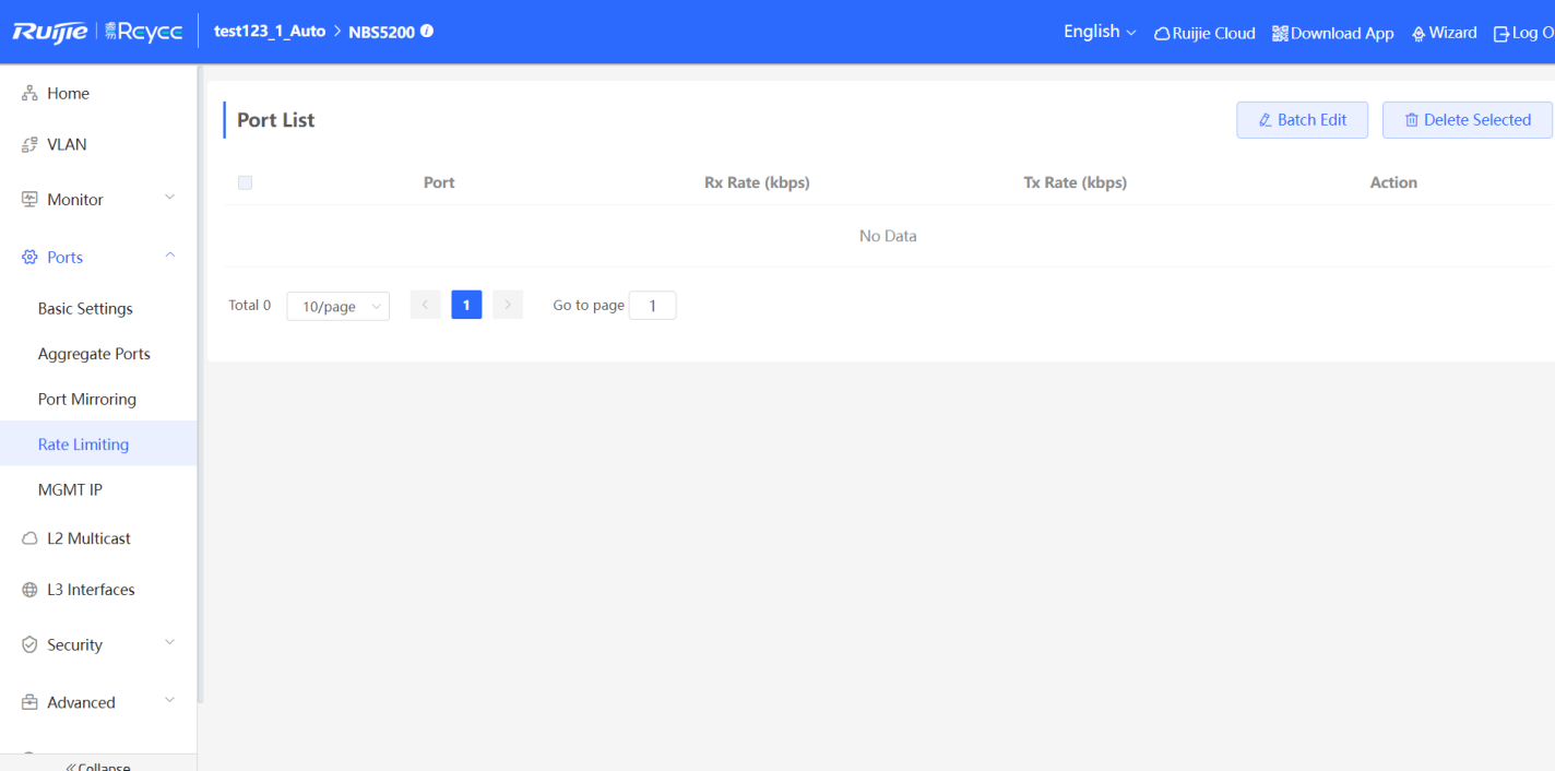

Configure path: Ports > Rate limiting

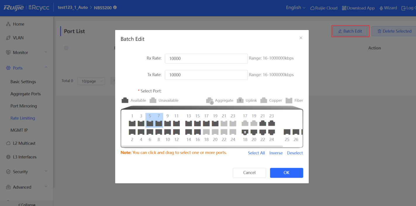

Click Batch Edit to config rate limit for the ports:

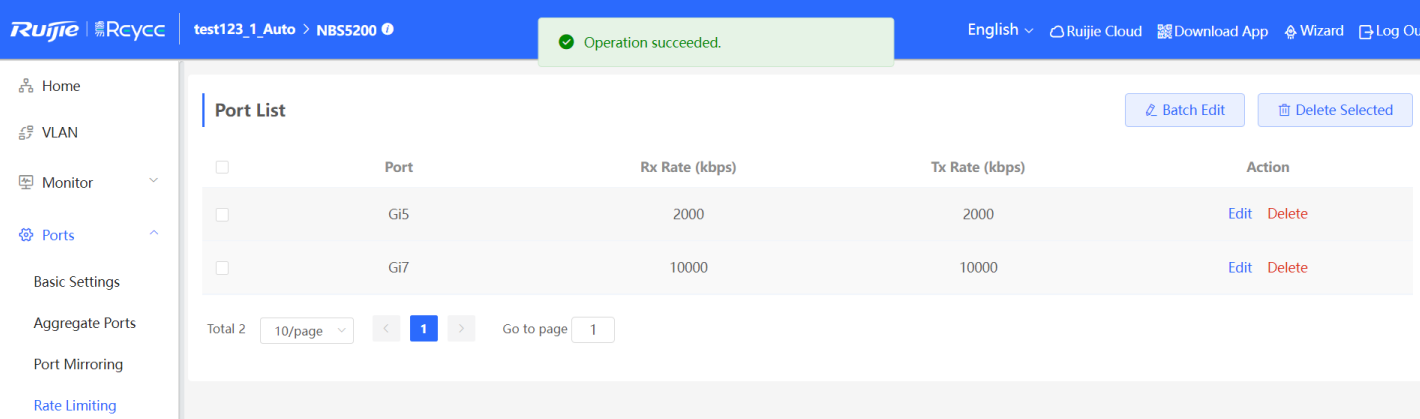

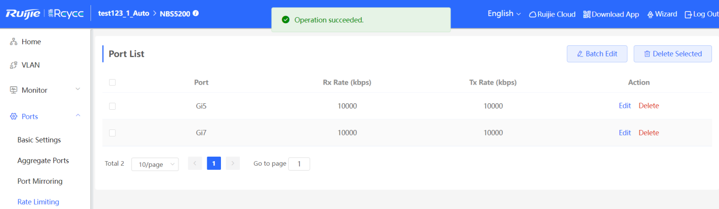

The message "Operation succeeded." is displayed, and the port list is updated.

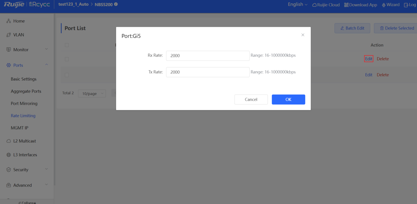

Click Edit in the Action column. In the displayed dialog box, set the Rx speed or the Tx speed, and click OK.
