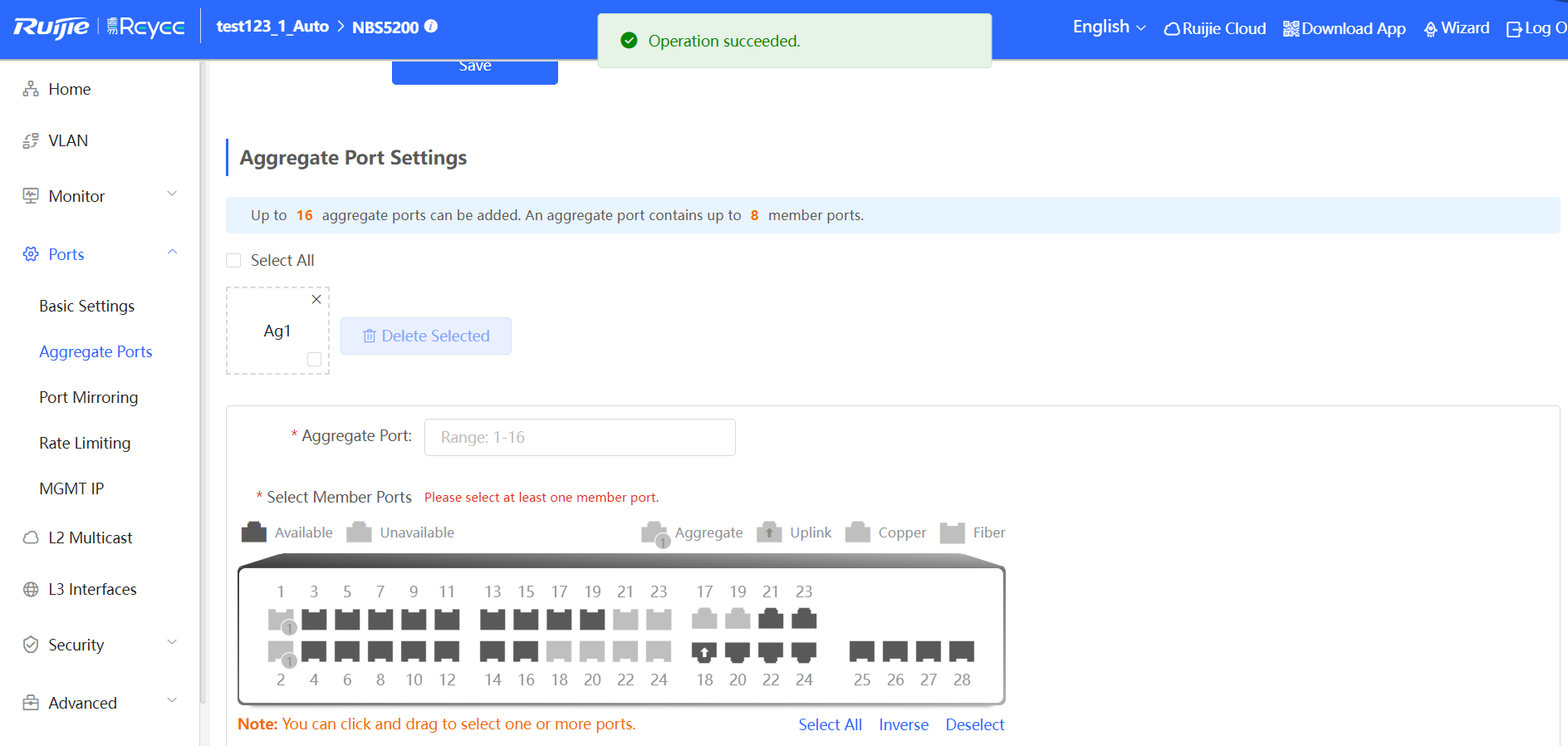

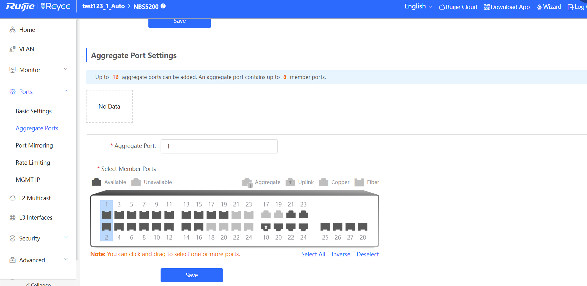

Configure Path: Ports > Aggregate Ports
a)Adding an aggregate port
Enter an aggregate port ID, select member ports (ports that have been added to another aggregate port cannot be selected), and click Save.
Notice: An aggregate port contains a maximum of eight member ports.

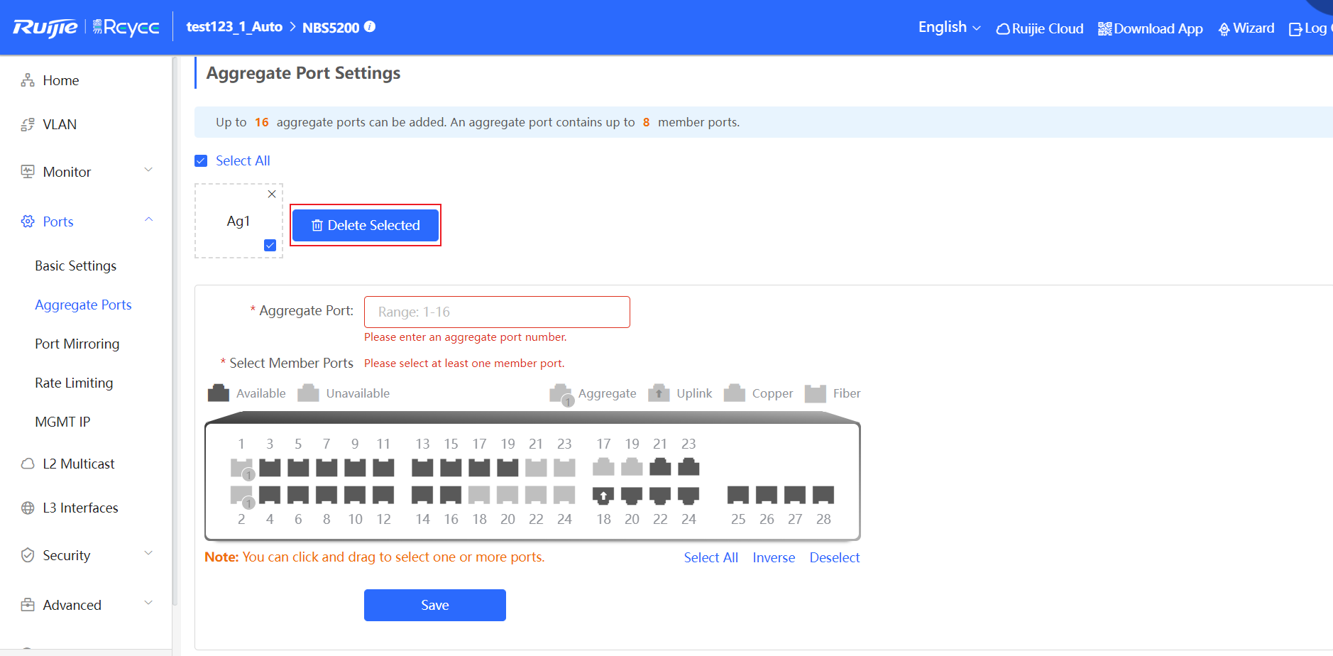

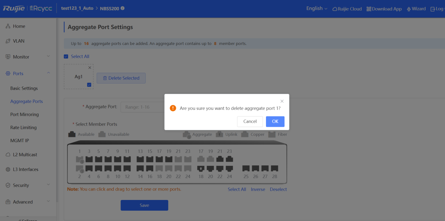

b) Delete a single aggregate port:
In the aggregate port list, click to select aggregate ports, and click Delete Selected.
A deleted aggregate port becomes available on the port panel.

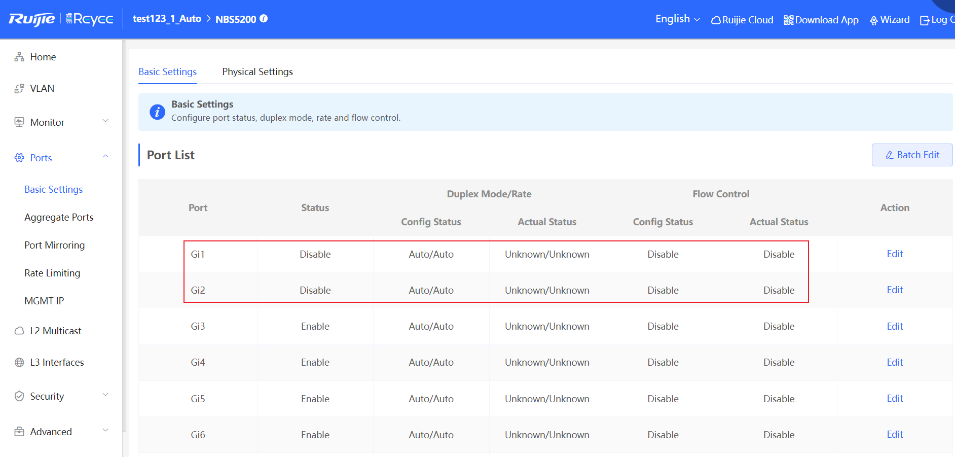

Notice: After the aggregate port is deleted, its member ports are restored to the default settings and are disabled.
