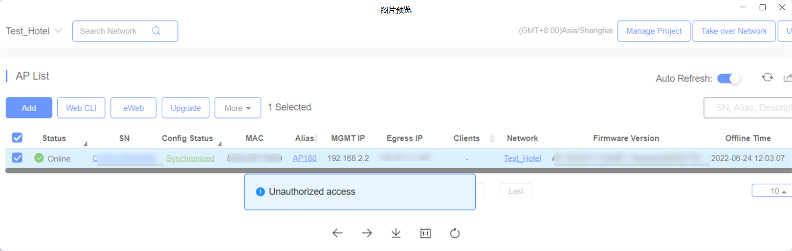

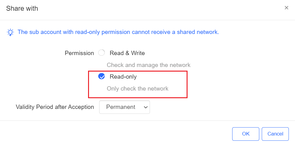

When you share the project on Cloud, please select the 'Read-only' permission, so that users cant not reboot device.
