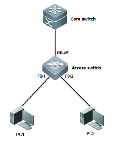

As shown in below, Core switch acts as the DHCP Server. Administrator wants to enable IP Source Guard to enhance the network security and prevent those users who configure illegal static IP address to accessing the network.
Network Topology
Configuration Tips
1. Core switch acts as
the
DHCP Server
2. Enable DHCP Snooping and IP Source Guard on Access switch to enhance network security

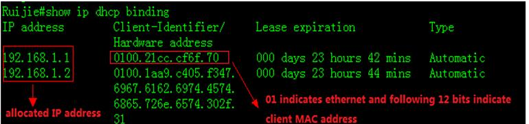

1. Display DHCP assignment

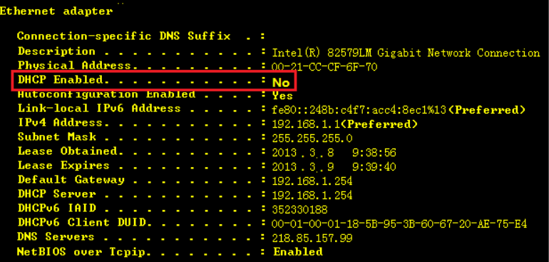

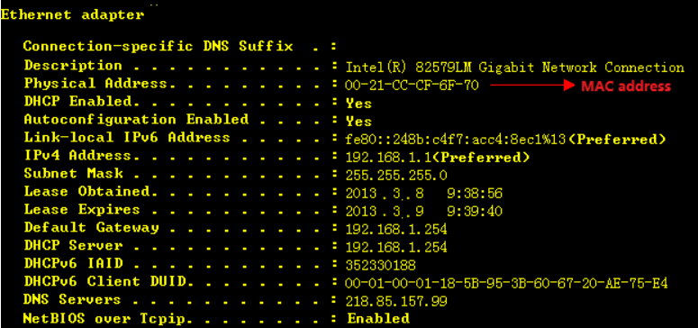

2. Display NIC status on station . Start -> Run -> cmd -> ipconfig/all

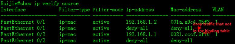

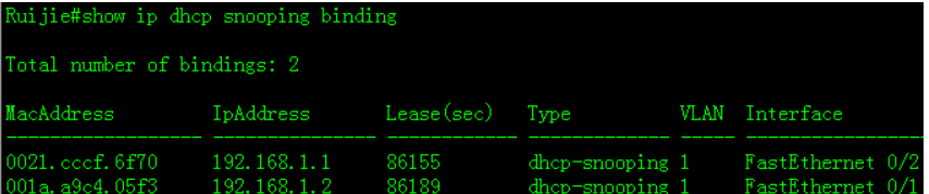

3. Display DHCP snooping binding table

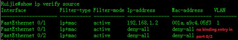

4. Display IP Source Guard table

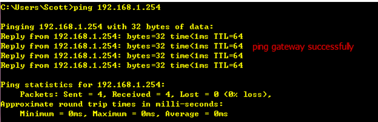

5. Use ping to test connectivity when station passes IP source Guard validation.

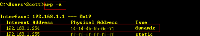

6. Display ARP table on station.

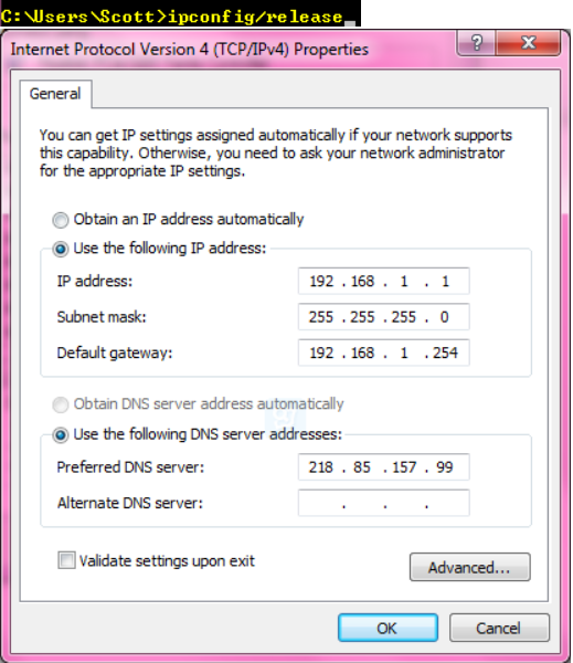

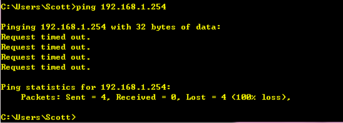

7. Execute "ipconfig/release" to release IP address assigned from DHCP, then configure static IP address
8. Confirm that we have assigned static IP address to station
9. There's no binding entry when we display IP source Guard table’
10. Use ping to test the connectivity when station doesn't pass the IP source Guard validation
