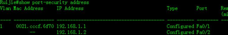

Verification
Display Port security table
