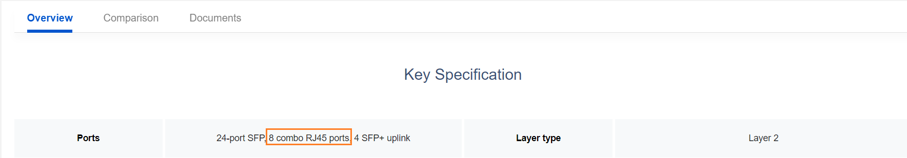

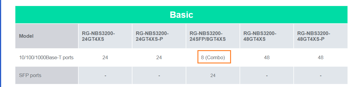

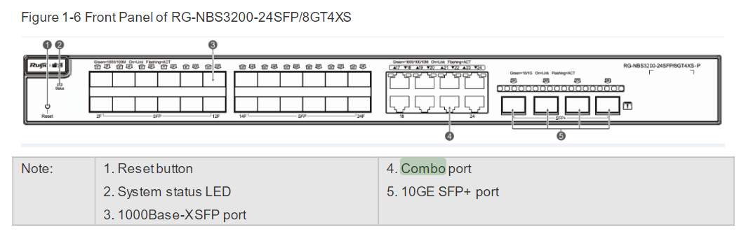

How can I know whether product has combo ports? Reply
3849 0 2022-7-14 15:12:37
Check on specification of the product.
Check on datasheet  of the product.
Check on hardware installation guide of the product.
