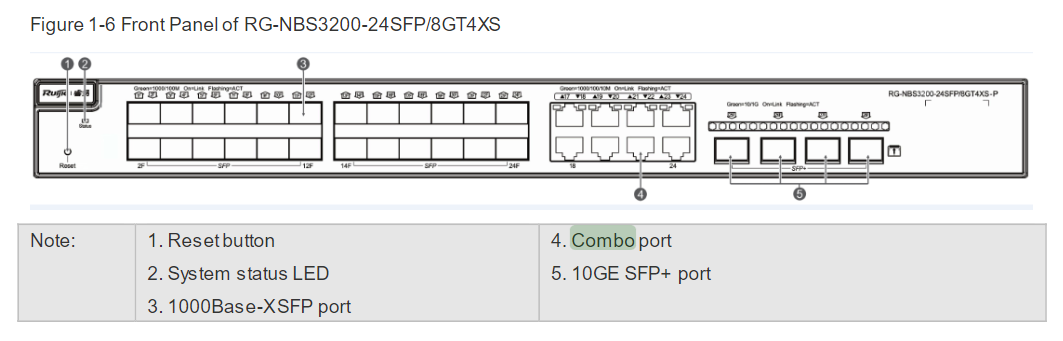

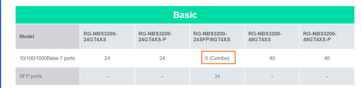

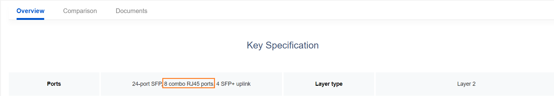

Check on specification of the product.
Check on datasheet  of the product.
Check on hardware installation guide of the product.
