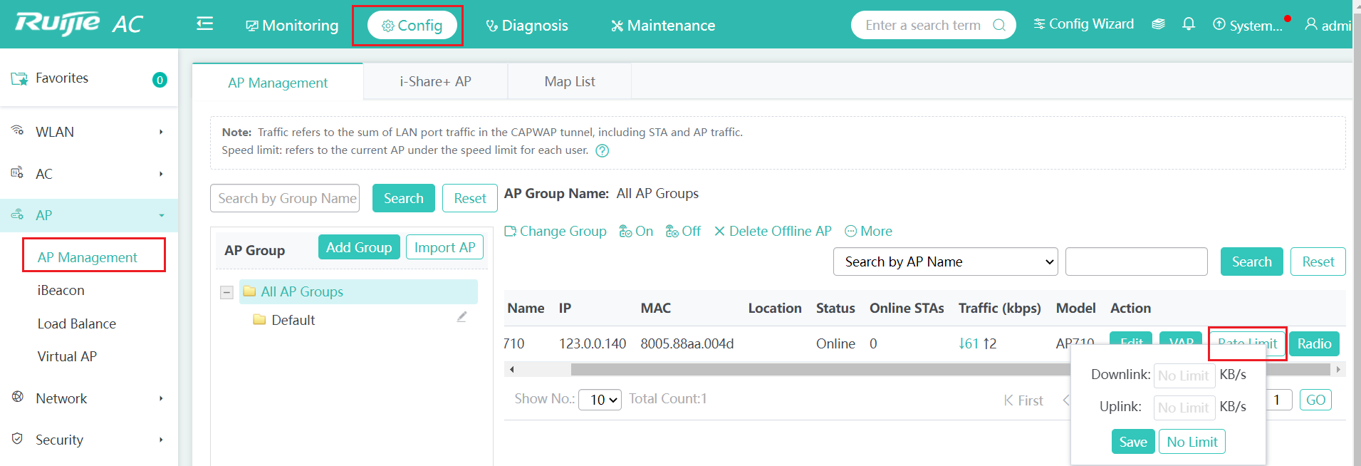

a) AP based Rate Limit
Ruijie(config)#ap-config ap-name
Ruijie(config-ap)#ap-based  { per-user-limit | total-user-limit  }  {down-streams | up-streams }  average-data-rate average-data-rate burst-data-rate burst-data-rate
Assign 800KBps average data rate and 1600KBps burst data rate to each wireless user connected to AP RJAP.
Ruijie(config)#ap-config RJAP
Ruijie(config-ap)#ap-based per-user-l
imit down-streams average-data-rate 800 burst-data-rate 1600
Attention: The unit is 8K Bit = 1K Byte.
Shown as the below picture, this policy is also supported to be configured in the eweb of AC.

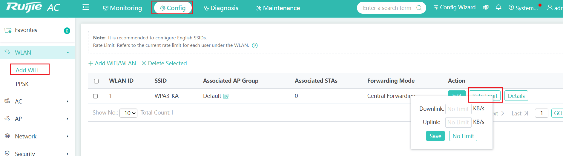

                                              b)Wlan based Rate Limit
1. The rate limit for each user of WLAN1 on the AC to set the average uplink and downlink traffic to 100KB.
Ruijie#configure terminal
Ruijie(config)#wlan-config 1
Ruijie(config-wlan)# wlan-based per-user-limit up-streams average-data-rate 100 burst-data-rate 200    //configure the up-stream rate
Ruijie(config-wlan)# wlan-based per-user-limit down-streams average-data-rate 100 burst-data-rate 200    //configure the down-stream rate
Ruijie(config-wlan)#end
This policy is also supported to configure on the eweb of AC.
