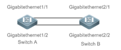

Scenario:
Configuration Steps:
● Add the GigabitEthernet 1/1 and GigabitEthernet 1/2 ports on Switch A to static AP port 3.
● Add the GigabitEthernet 2/1 and GigabitEthernet 2/2 ports on Switch B to static AP port 3.

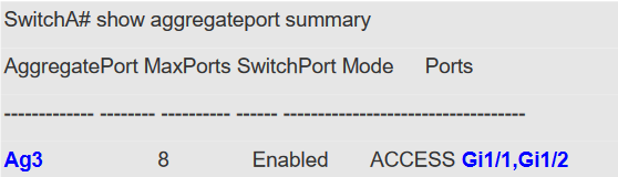

Verification:
Run show aggregate port summary to check whether AP port 3 contains member ports GigabitEthernet 1/1 and GigabitEthernet 1/2
