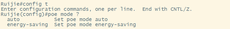

Show in the below picture, can use 'poe mode auto' and 'poe mode energy-saving' commands to chang the PoE mode
Notice: After change the POE mode, need to power off to restart the switch and then the command will work

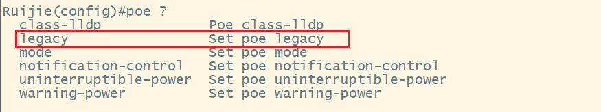

Switch also support to use 'poe legacy' to enable compatible functions to adapt some non-standard PSU.
