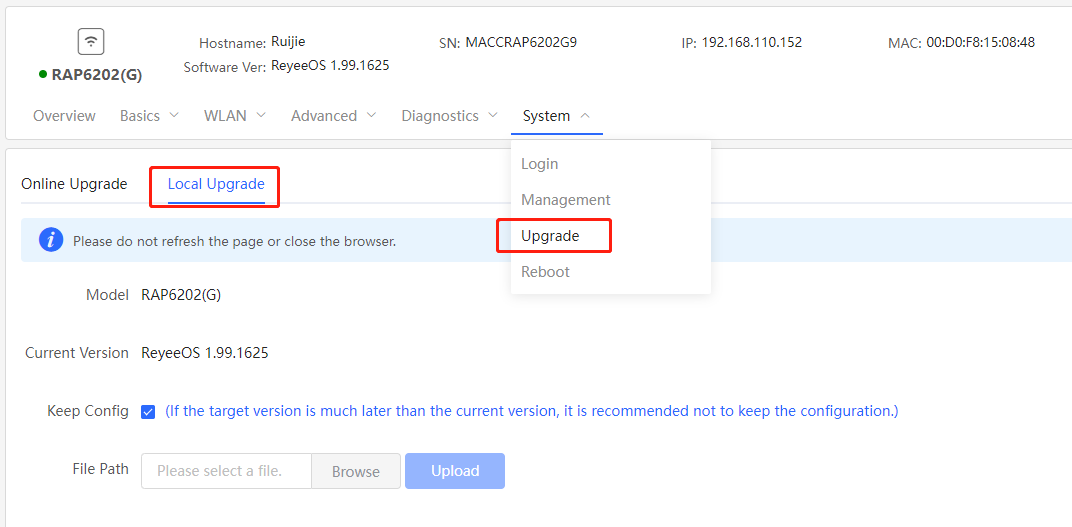

If you want to try Reyee AP MESH, please download and upgrade the firmware to the latest version first.
Firmware link: https://singapore-1312056779.cos.accelerate.myqcloud.com/support/documents/slide_77180
After getting firmware, please login local web page and upgrade.
Step1: Click System > Upgrade > Local Upgrade
Step2: Click Browse and upload the firmware.
Step3: Restart the device.
From the next batch of products, the firmware with Reyee AP MESH will be installed in default.
Thanks for choosing Ruijie Reyee.
