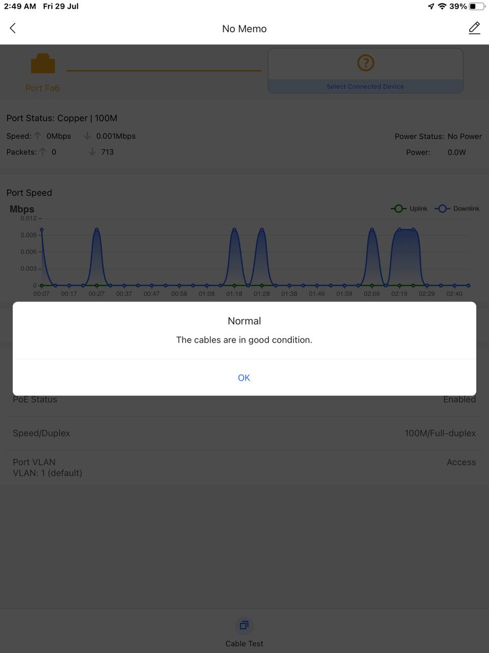

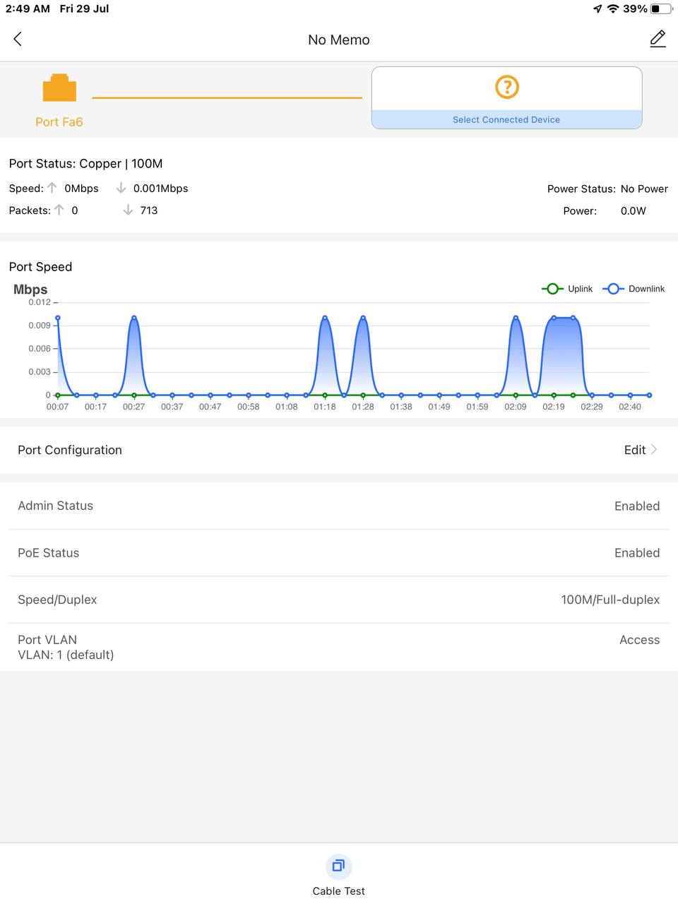

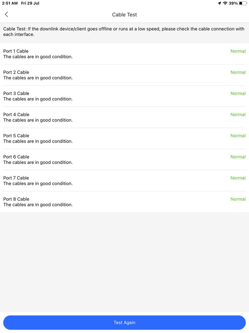

I saw there is cable test option for the switches. However, there is only NORMAL and maybe ABNORMAL as I dun have a cable that's not OK yet.
I would like to know if there is any further details to be built into the UI of app/web console ?
Is there any CLI command that can do the same and provide us full technical details with data?
eg, data transmission type, speed, packet, POE power consumption, estimated cable length, response time , channel, pair status etc
With an OK status doesn't help much to detect if a cable is worth inspecting or not

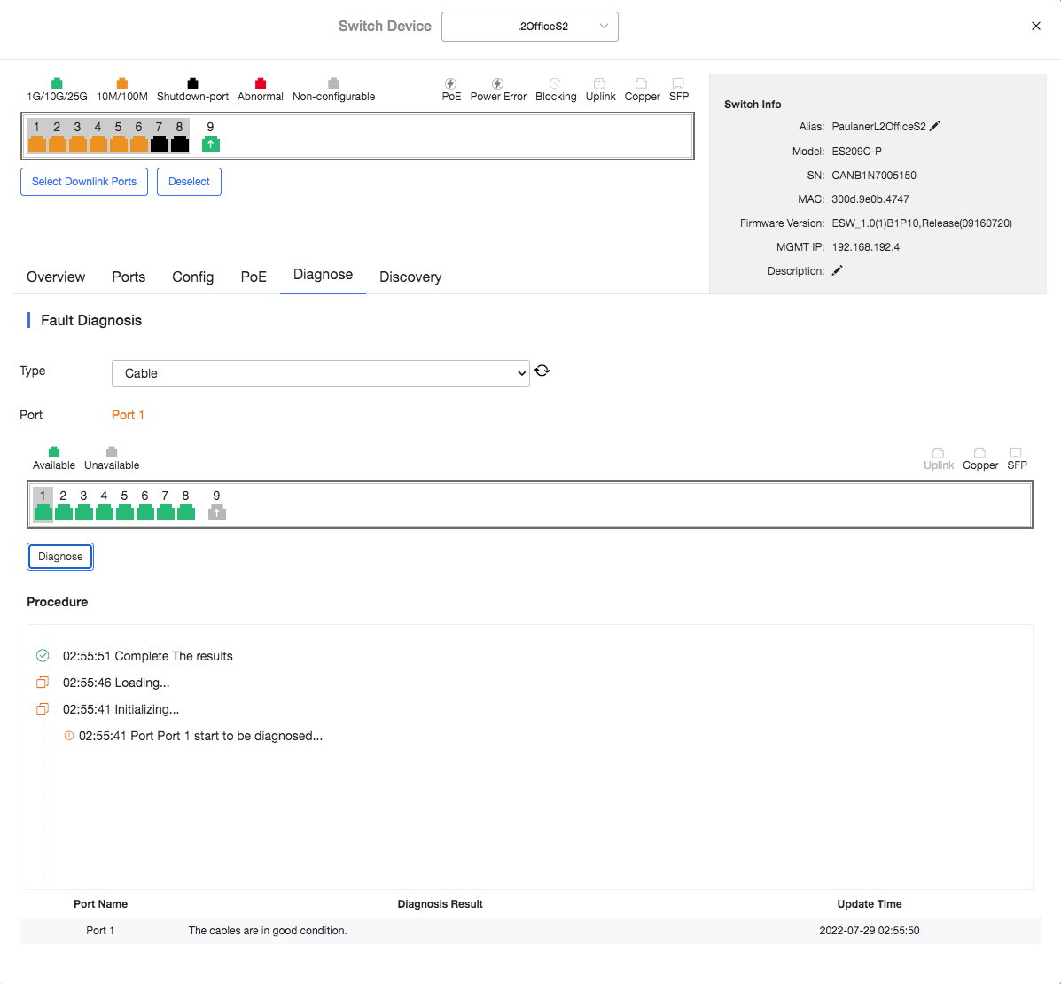

Dear Sir
I'm glad you're using our product. The reyee switch can't use cli
Second, as for the detailed inspection information about the cable you mentioned, it is not supported for the time being. We will collect your comments for feedback

In what condition would a cable being detected as not OK ?
If CLI is not an option, what can we do ? Or any other model can handle this? Not even WebCLI?
