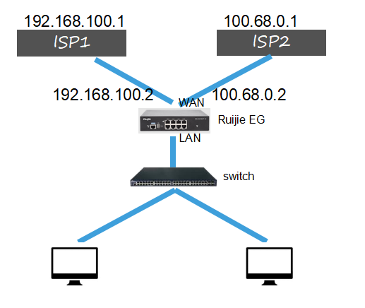

When an EG device is on the dual-network line, the active/standby failover can be implemented automatically through routing
Topology:
Set interface 192.168.100.1 as the primary interface, and all traffic goes through the interface first. When the interface fails, all traffic switchover to the 100.68.0.1 interface.

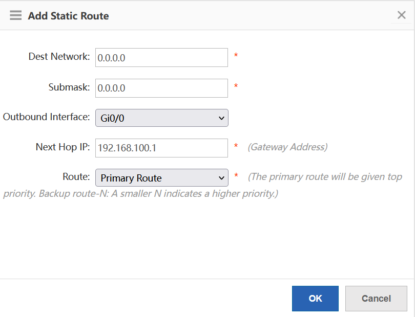

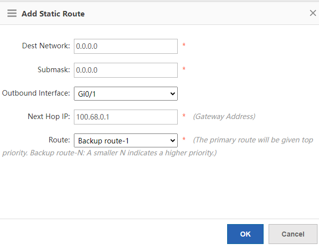

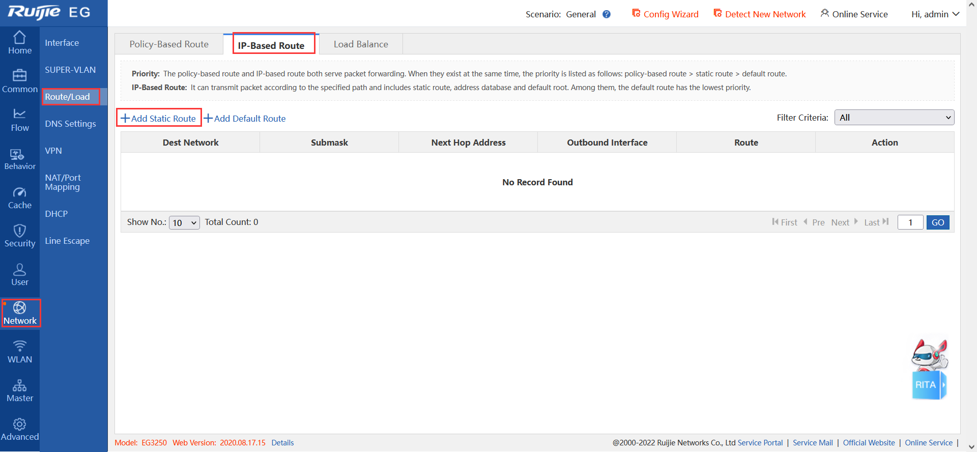

Step 1: Click Network > Route/Load > IP-Based Route >Add Static Route to add two default routes.
Step 2: Configure the route settings. The destination network and submask are both 0.0.0.0, but different next hops must be associated. Ensure that one is the primary route and the other is the backup route.

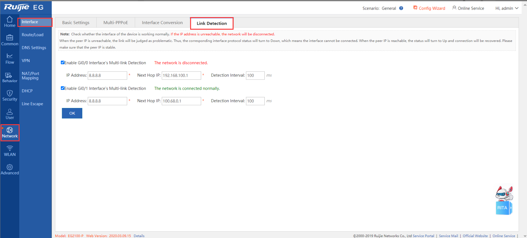

Step 3: Click Network > Interface > Link Detection, enable link detection function
