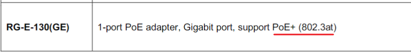

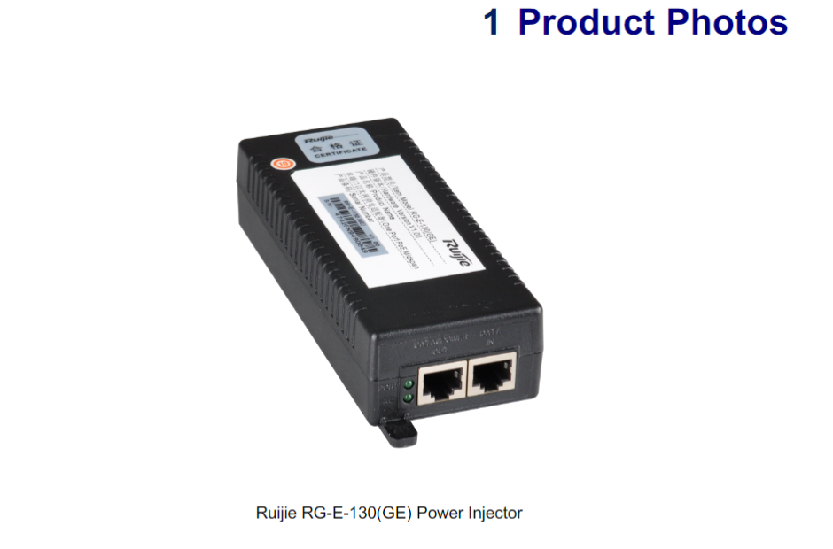

Hi sir, thank for the reply, you can use the RG-E-130(GE) as the poe power supplier for this AP. Here is the information for that.
https://www.ruijienetworks.com/resources/preview/74033

Hi Sir,
thank you very much, problem solved

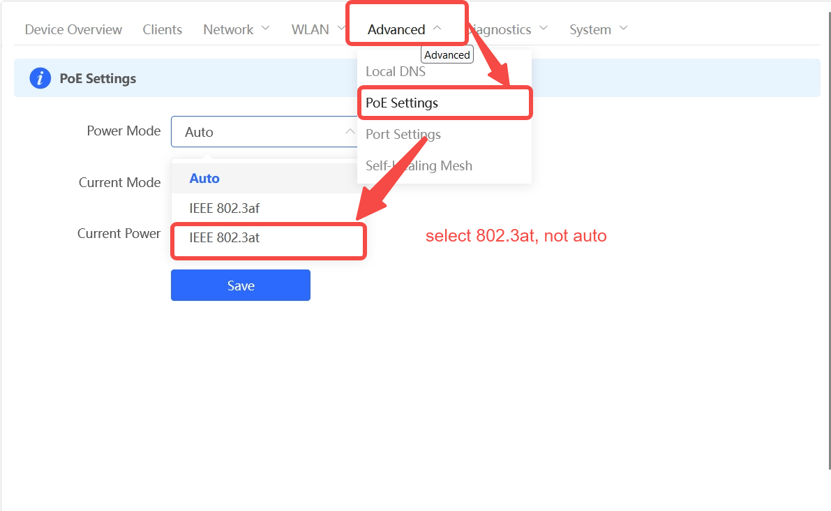

Dear:
As my colleague explained before
,  the PoE protocol that needs to be used is 802.3at:
And your PoE injector supports this protocol.
If you can not see the 5GHz band on your side, please try to change the PoE protocol your AP currently uses:

Hello Javier.
I made the suggested change and it worked! The message no longer appeared and the 5Ghz is working.
Thanks!!!
Now, it's quite strange that it doesn't work correctly with the AUTO option.
