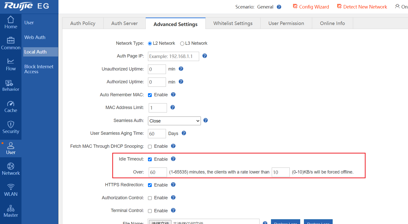

How to configure the idle timeout for the authenticated users on the EG prodcuts? Reply
3751 0 2022-8-19 11:23:25
As shown in the below picture, you may configure the IDLE Timeout feature on EG, then the clients with a  lower rate beyond a certain duration will be forced to offline.
RG-EG105G V2
Configuration Technical Introduction Router
