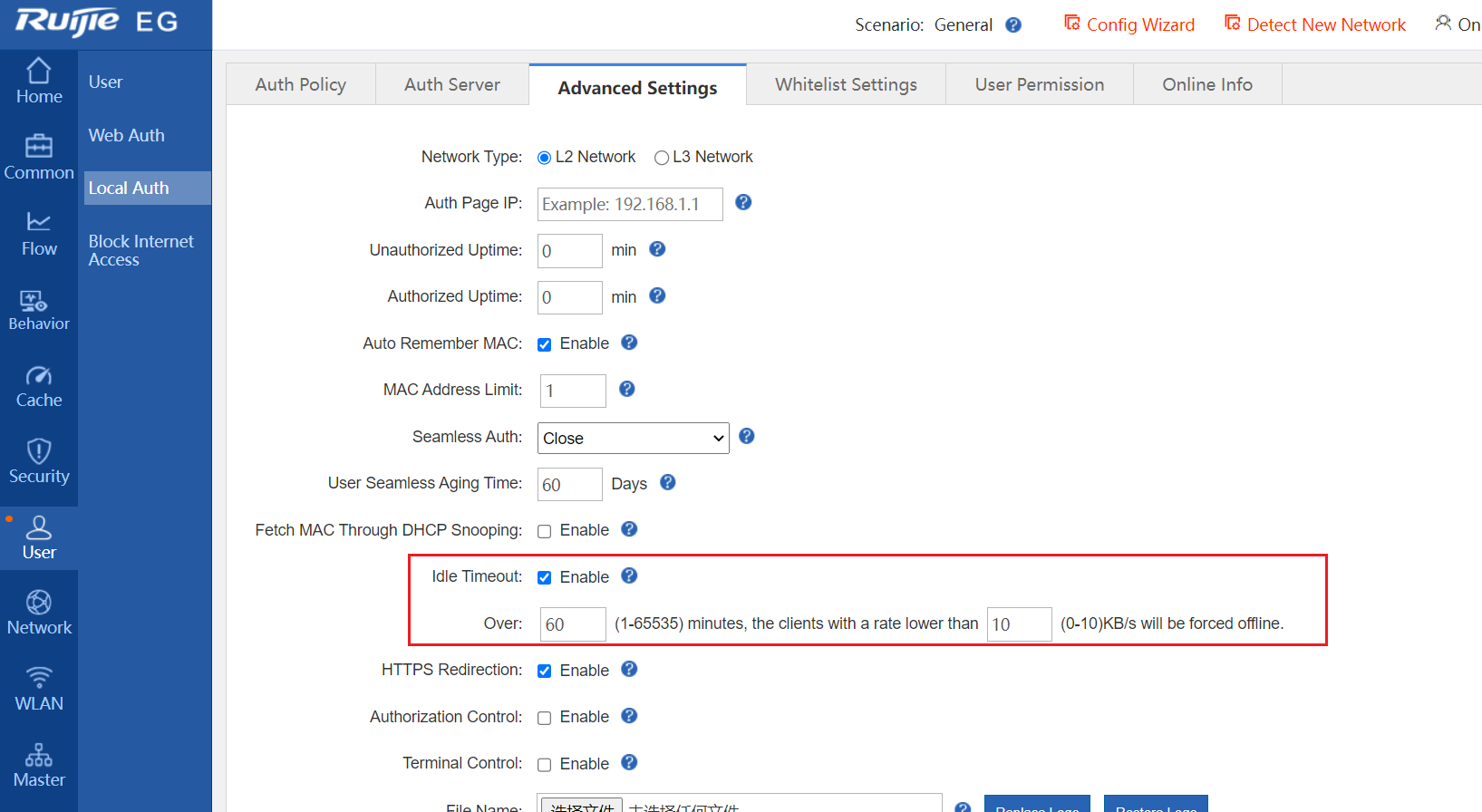

How to to make the authenticated users who will be kicked out automatically when they have no taffic on the EG products? Reply
4109 0 2022-8-19 11:25:34
As shown in the below picture, you may configure the IDLE Timeout feature on EG, then the clients with a  lower rate beyond a certain duration will be forced to offline.
RG-EG3230
