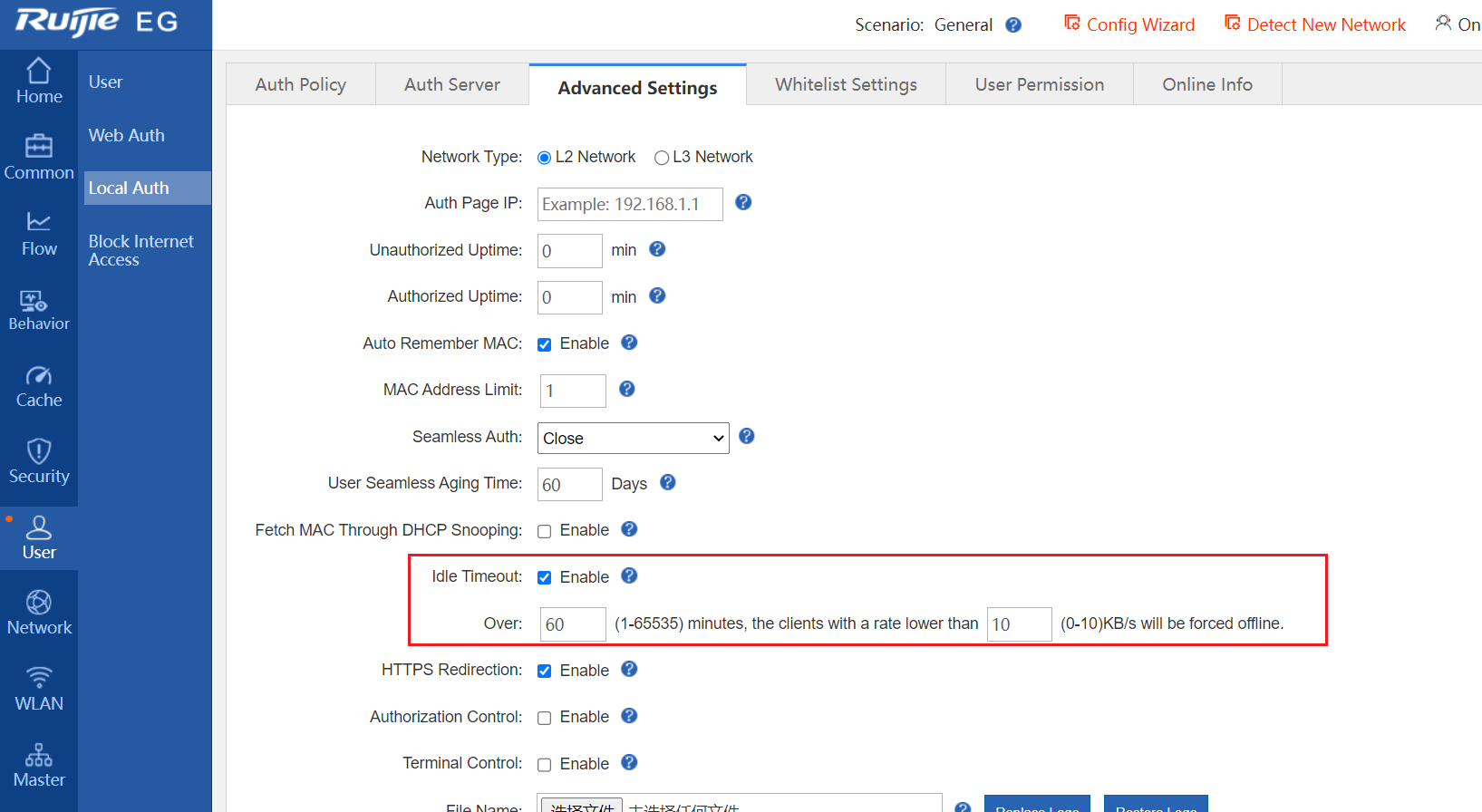

How to to force the authenticated users offline when they have no traffic on EG? Answer: Reply
3756 0 2022-8-19 11:26:55
As shown inthe below picture, you may configure the IDLE Timeout feature on EG, then the clients with a  lower rate beyond a certain duration will be forced to offline.
