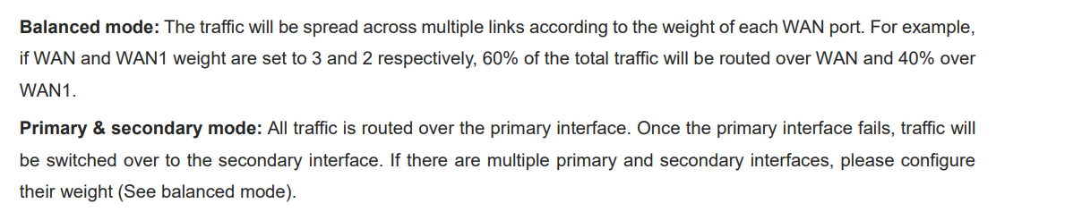

Hi sir, sorry for not reply timely, you may refer to the below picture.
if  Wan0 = 500 MB And Wan1 300 MB, then we suggest WAN0:WAN1 =5:13

If Wan0 =  5 MB And Wan1  3 MB       Suggest WAN0:WAN1 = 5:3.  the weight ratio == the ratio of two WANs
