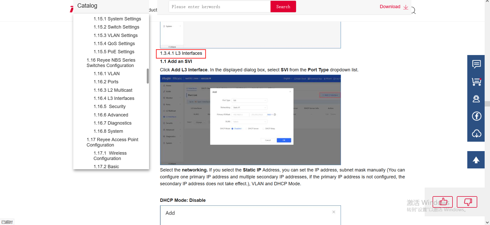

Is there a document that show examples for configuring inter-vlan routing for RG-NBS5200-24GT4XS? Looking to add the NBS5200 as a distribution switch for 2 NBS3200 switches.
RG-NBS5200-24GT4XS
Switch Configuration Network Setting
0 2022-9-5 10:07:26 View all replies
Yes, this switch model RG-NBS5200-24GT4XS can support configuring inter-vlan routing, you can follow this guide:
https://www.ruijienetworks.com/support/documents/slide_76987#_Toc20865

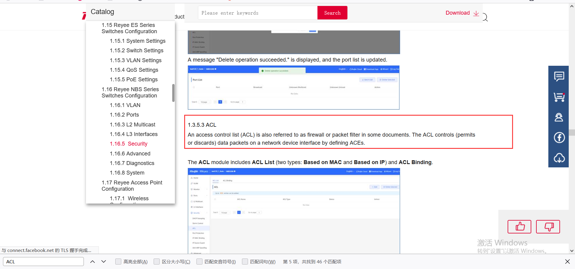

Hello Jenny, I have a RG-EG3230 configure with 5 Vlans. Is there a document that have example how to block inter-vlan routing? I would to configure which vlans can talk to each other. I currently have 2 - RG-NBS3200 switches connected via trunk port. I will add a RG-NBS5200 switch in the future.

May I know you want to block inter-vlan routing on EG or on the NBS switch, you can configure ACL to achieve this:
Here is the guide to configure ACL on ruijie eg:
https://community.ruijienetworks.com/forum.php?mod=viewthread&tid=1905
Here is the guide to configure ACL on NBS switch:

Hello Jenny, I will do the inter-vlan blocking at the EG level, then add a distribution switch, so not to daisy chain switches. Hoping for Ruijie and Reyee products to become available in the USA. I will post more on Social Media. Thanks again,
