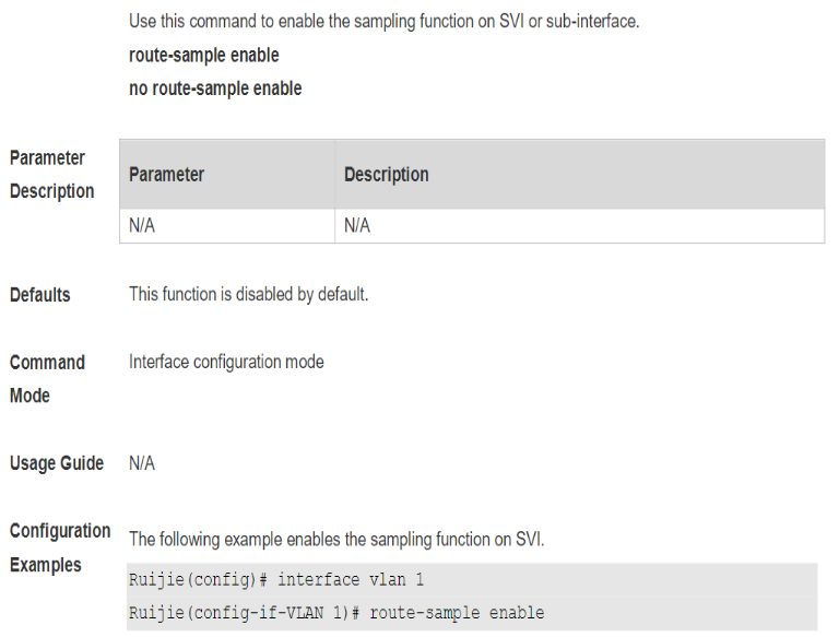

This function is disabled by default, and you have not configure it, please try config it for vlan interface.

we have enable it right now.
interface VLAN 71
route-sample enable
ip address xxx.yyy.ddd.254 255.255.255.128

the value statistic still 0.. any idea?

Sorry, the firmware versions do not support this value statistic
at present.

route-sample enable... it is not working in your official doc ?
hemm.. do u have any solution for this ruijie model S6220-48XS6QXS-H
