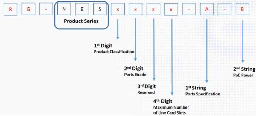

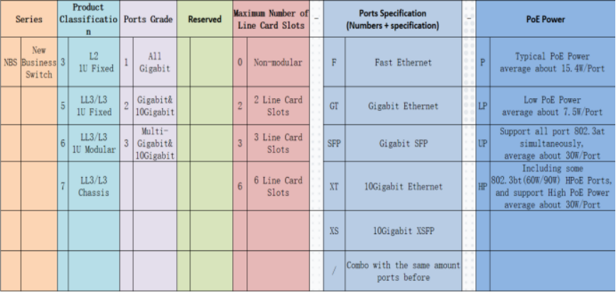

1.The full name of NBS:New Business Switch
Here is the naming standard of NBS Series Switch:

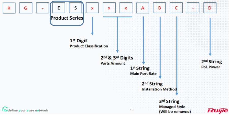

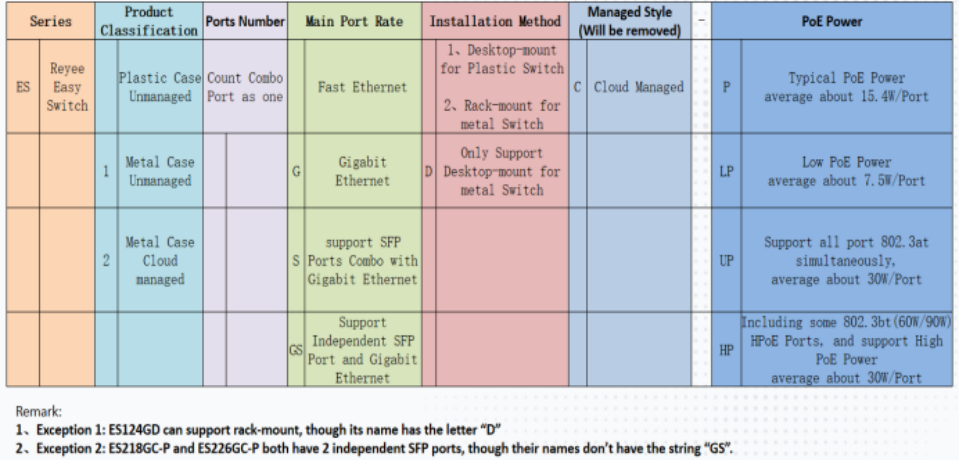

2.The full name of ES:Easy Switch
Here is the naming standard of ES Series Switch:
