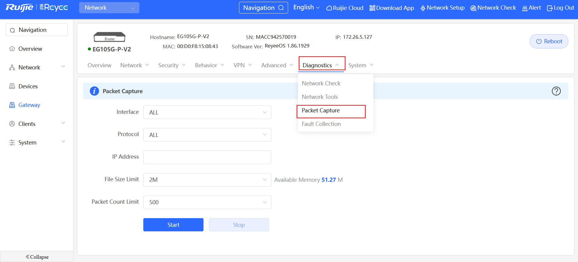

You can try to capture the packets here, if you block some ports, the packets will not be captured:

Hi Jenny,
If I understand it correctly, there is no default logs for the firewall and to have that logs we reuqired to use the packet capture debug logging feature.  Is that correct?

Yes, you are right. On the EG105GW, you may need to capture packets to check the corresponding information. Sorry for making you any inconvenience.
