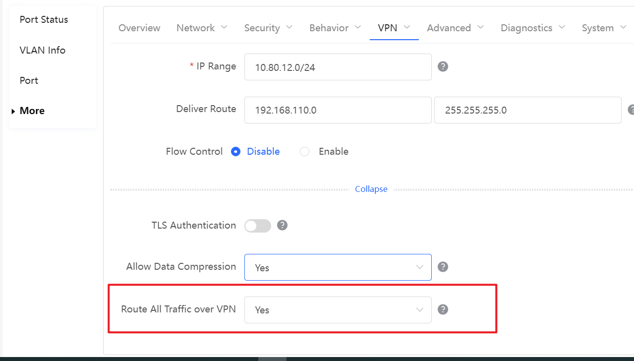

For reyee EG, we are suggest to conifgure open VPN to achieve that, you may refer to the following post to configure Open VPN in Reyee EG.
https://community.ruijienetworks.com/forum.php?mod=viewthread&tid=2866
0 2022-10-24 17:43:15 View all replies
GTAC-Wayne replied at 2022-10-24 17:40
Hi sir, sorry for not reply timely.
For reyee EG, we are suggest to conifgure open VPN to achieve th ...
Please keep the below option as 'Yes', then the traffic of clients will go through the server
0 2022-10-24 20:04:34 View all replies
GTAC-Wayne replied at 2022-10-24 17:43

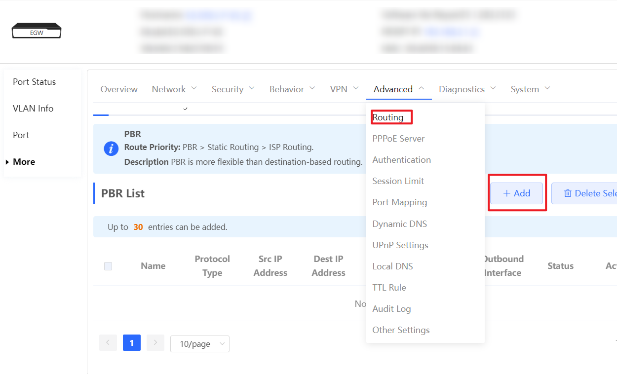

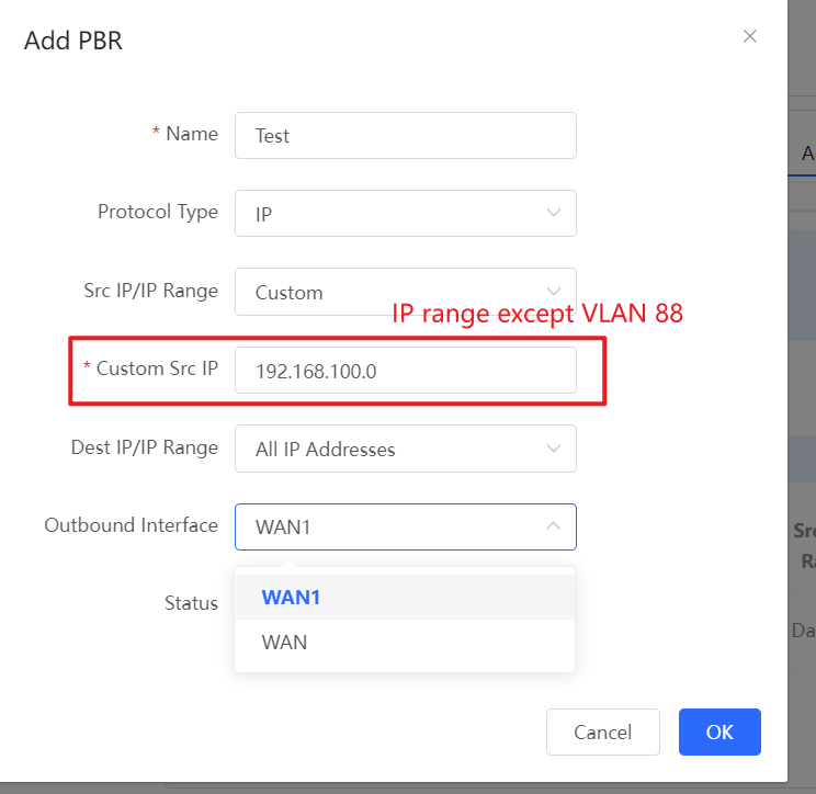

Hi sir, you can try configure the PBR in the branch to allow except vlan88 to go through the WAN port of EG to access the internet.
