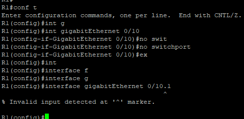

Usually an interface is created, but apparently this functionality is not supported on this model
Because of this, I raised the issue of the ability to configure a subinterface
Thank you Jenny, but it's not working
If someone can say for sure whether the functionality is included in this model or not, it would be nice

Sorry as I further check that the DCN switches in 11.x version can support sub-interfaces, for example, N18-X/6220/6220-H/6510/6520/6250. While the S5760C-48GT4XS-X is campus switch does not support sub-interfaces. Sorry for the inconvenience.
