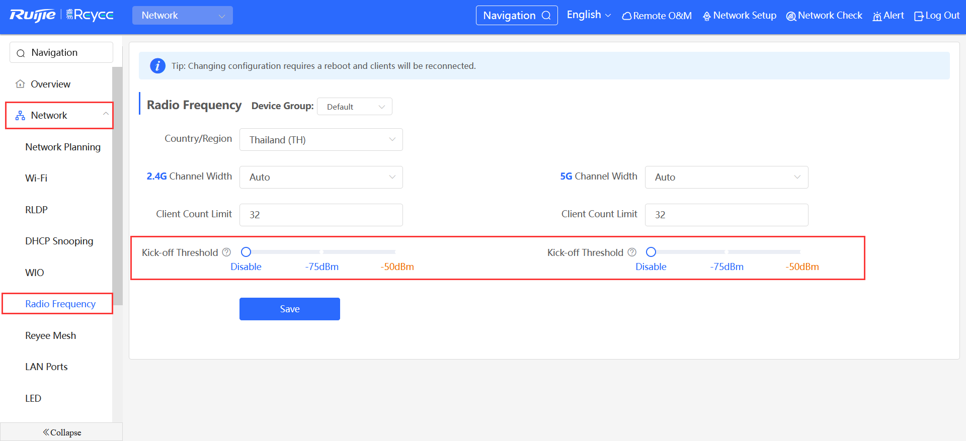

After you login to the AP eweb, you can configure kick-off threshold dBm on Reyee AP here:
Jenny
0 2022-11-11 11:29:08 View all replies
GTAC-Jenny replied at 2022-11-11 09:41
After you login to the AP eweb, you can configure kick-off threshold dBm on Reyee AP here: ...

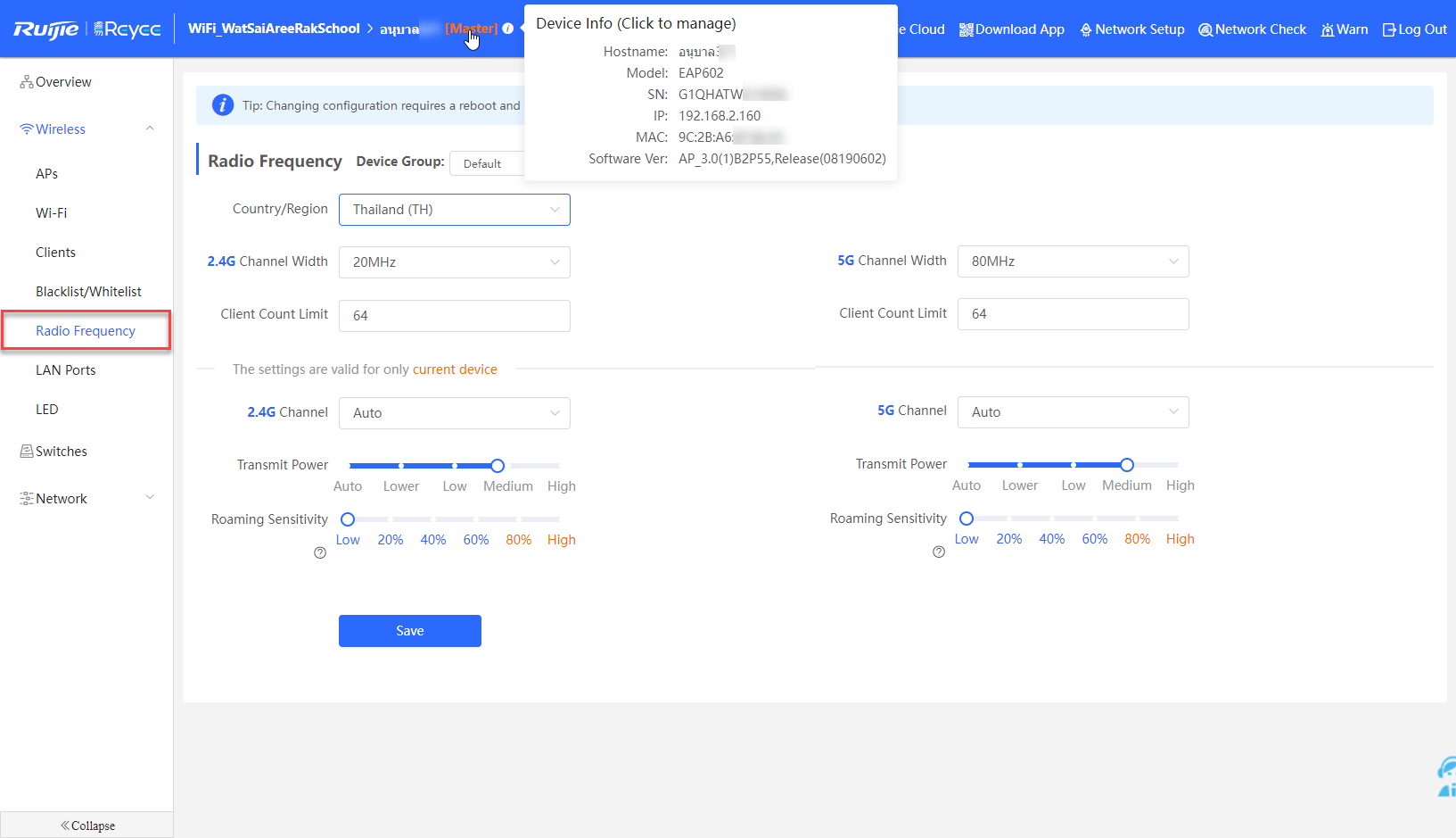

Dear Jenny,
I cannot find kick-off threshold menu on EAP602 but can find from other model such as RAP2260(G). Please advise EAP602 software version that can support kick-off
threshold?

Dear Yai
Sorry sir, as further confirmed that EAP602 cannot support kick-off function. Sorry for making you any inconvenience.
