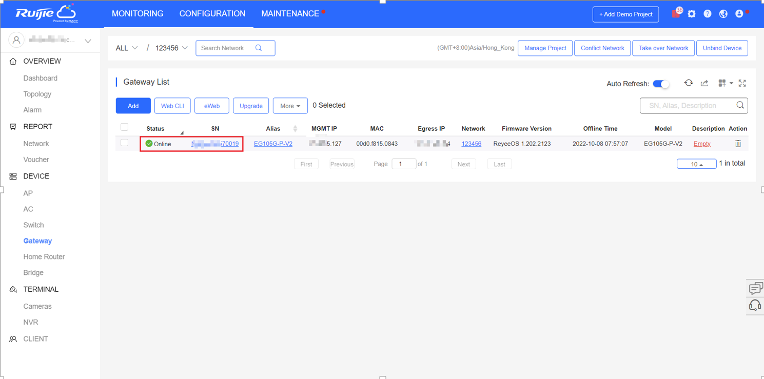

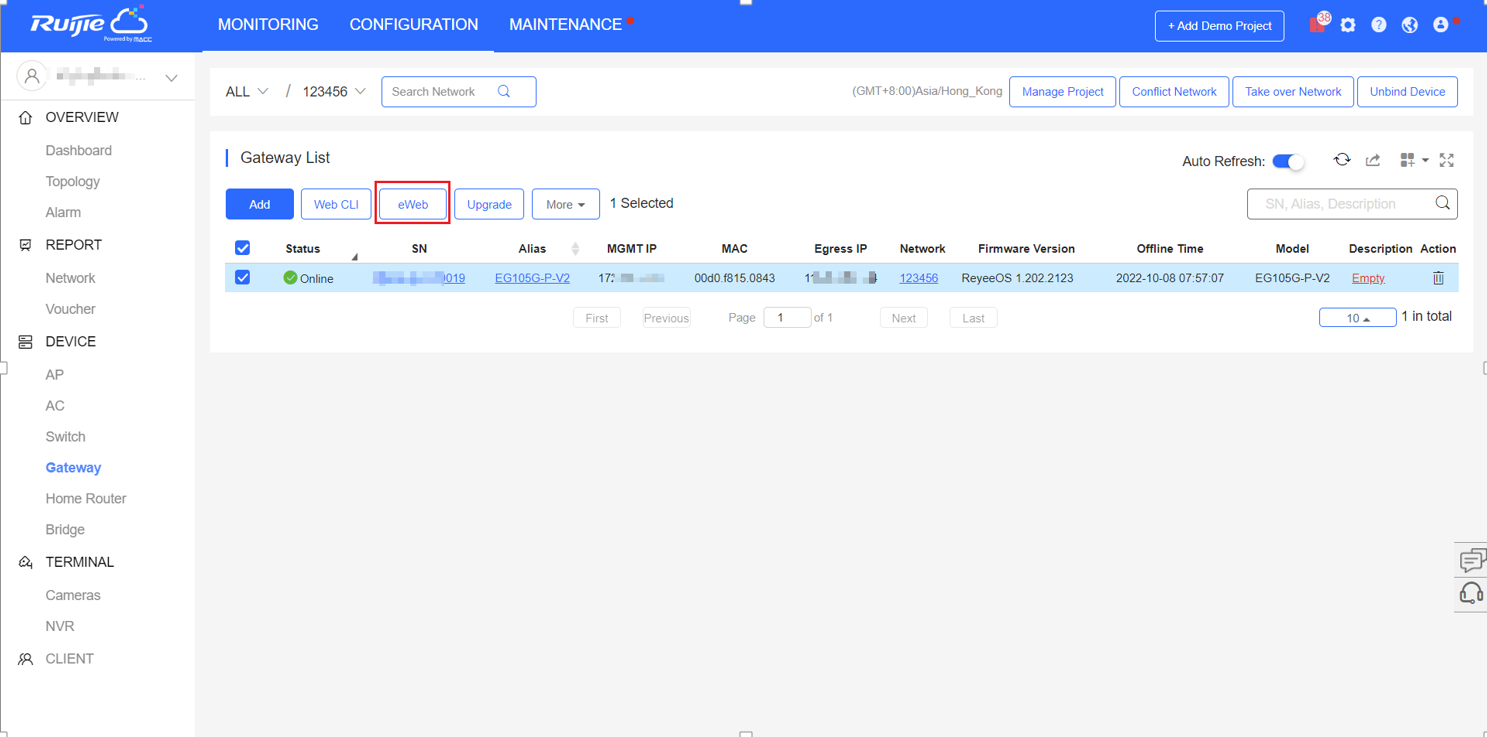

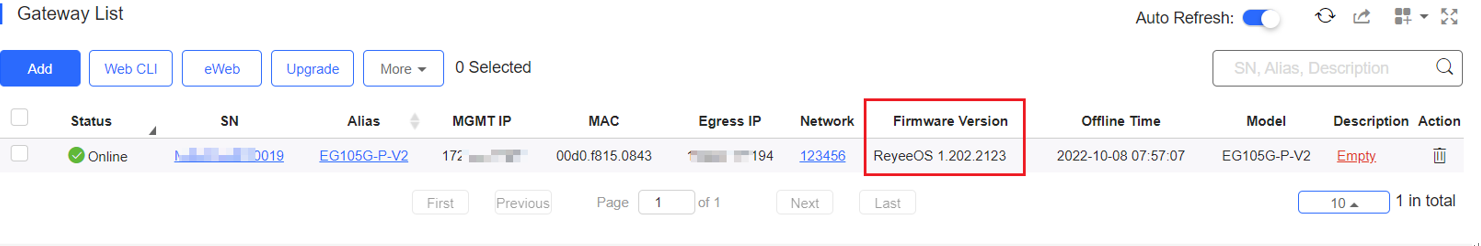

Step 1: Make sure the Reyee EG is online on Ruijie Cloud and click its SN in the list to enter the configure page.

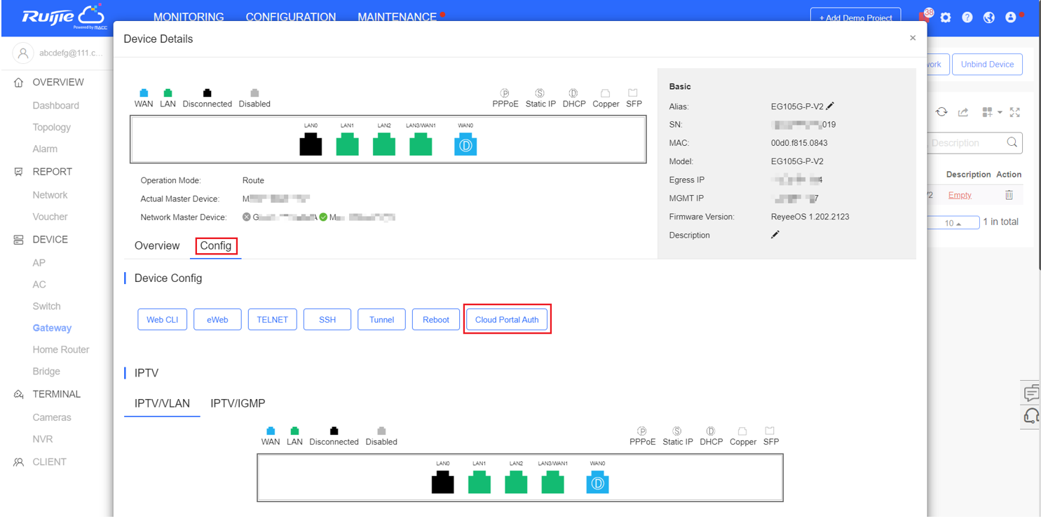

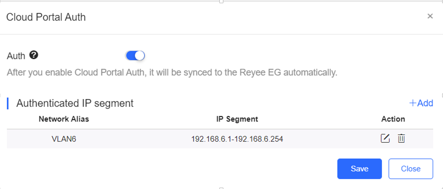

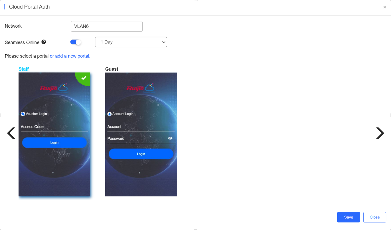

  Step 2: click the ‘Cloud portal Auth’ to configure the portal on Cloud
Notice:
Gateway P202 firmware is required.

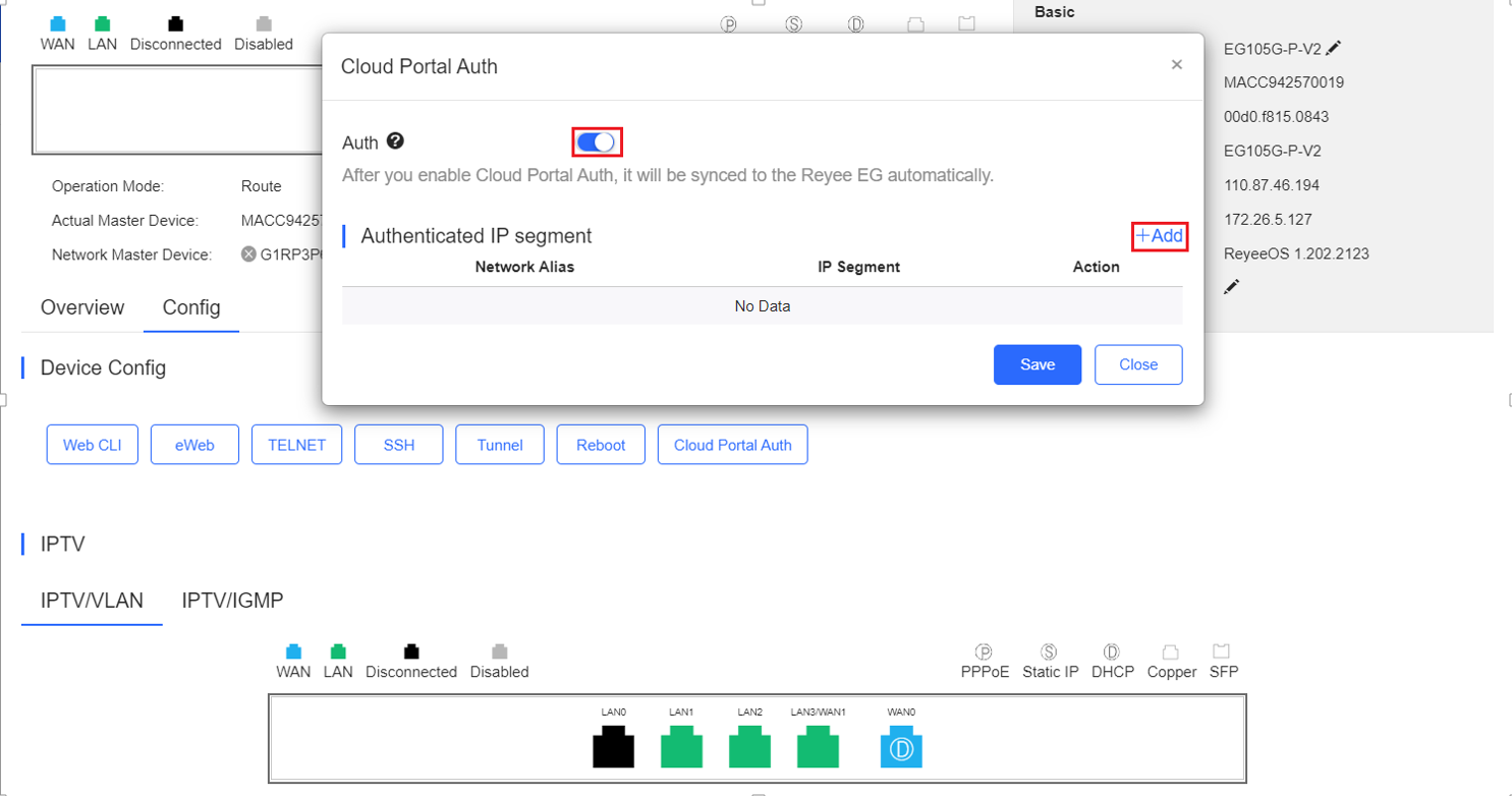

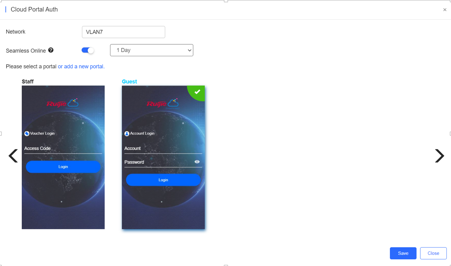

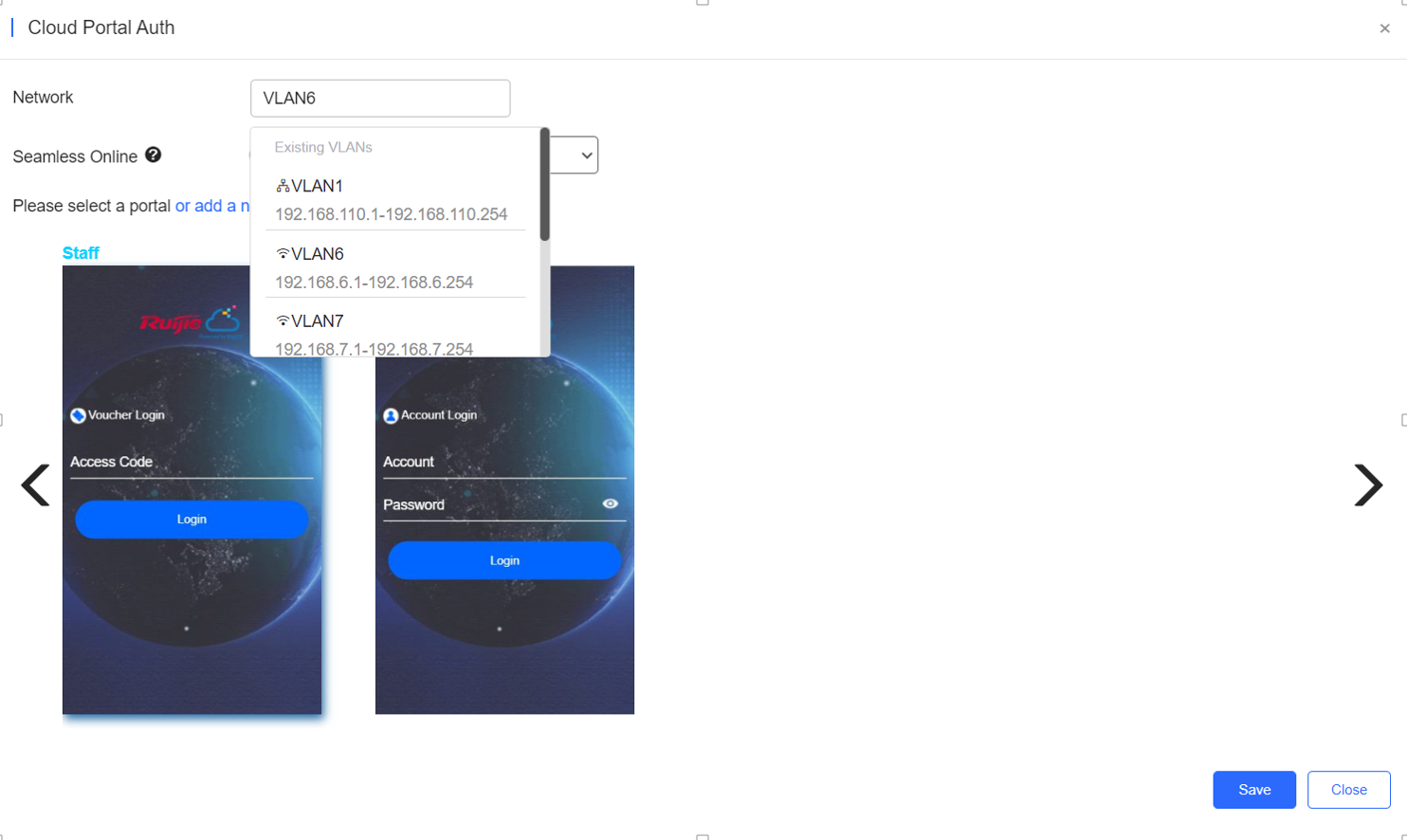

Step 3: Enable the Auth firstly, then click Add to select the vlan which need to authenticate and choose the portal template to be used. In the end, click ‘save’ to save all configurations.
Select VLAN 6 and choose the portal template for VLAN 6,
Select VLAN 7 and choose portal template for VLAN 7

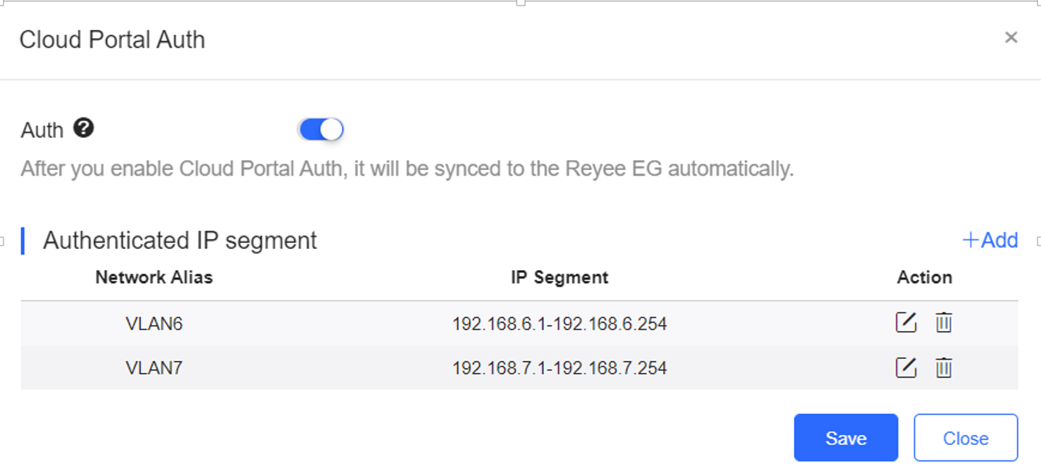

Notice: Exclude the IP of connected devices, it is recommend using different VLAN for users and devices.

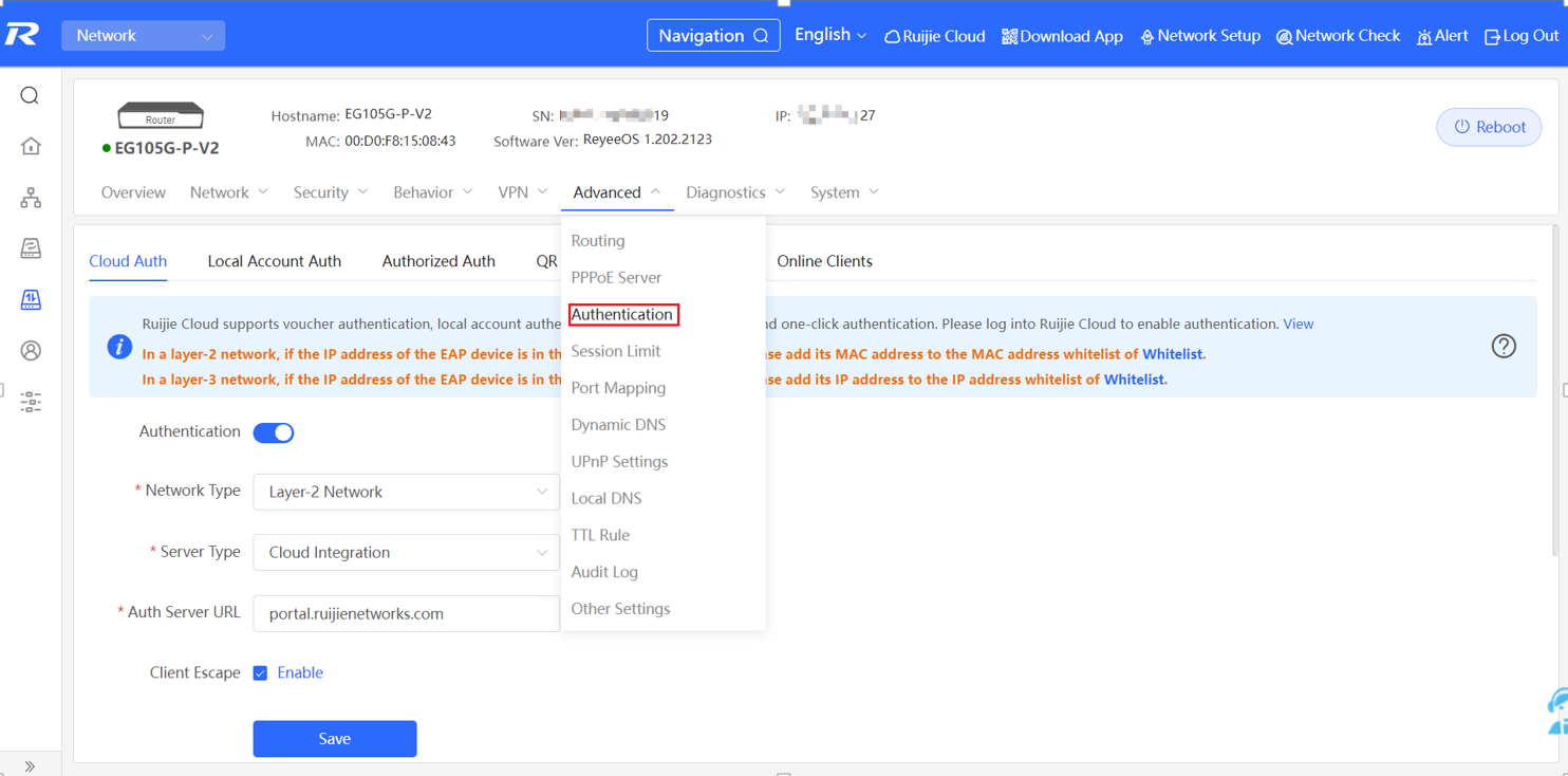

Step 4: enter the Eweb of Reyee EG

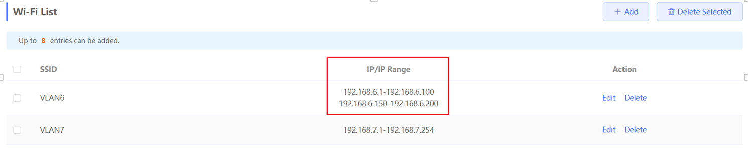

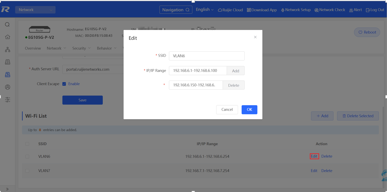

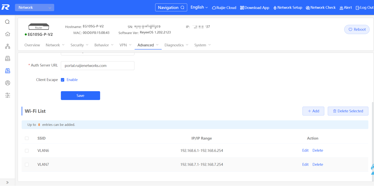

Step 5: enter the ‘Authentication’ page of this Reyee EG, click the ‘Cloud Auth’, you can see the Authentication was enabled, and the IP range was synchronized here.
Notice:
If you want to change the IP range of the authentication, you may click Edit to change it:

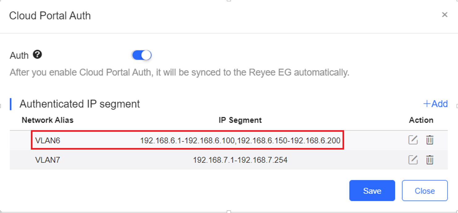

It will synchronize to cloud:

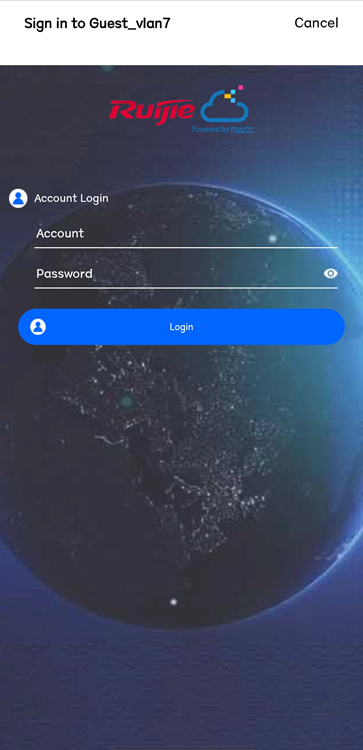

Users connected to VLAN 6 and VLAN 7 will get a different portal authentication interface:
