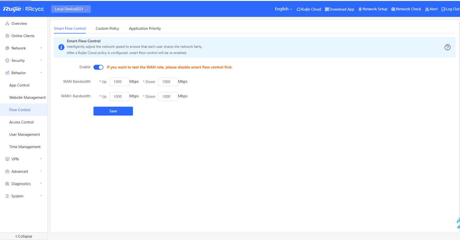

1. Close the flow control function test of EG    // flow control will limit the speed, resulting in access to the external network stuck
