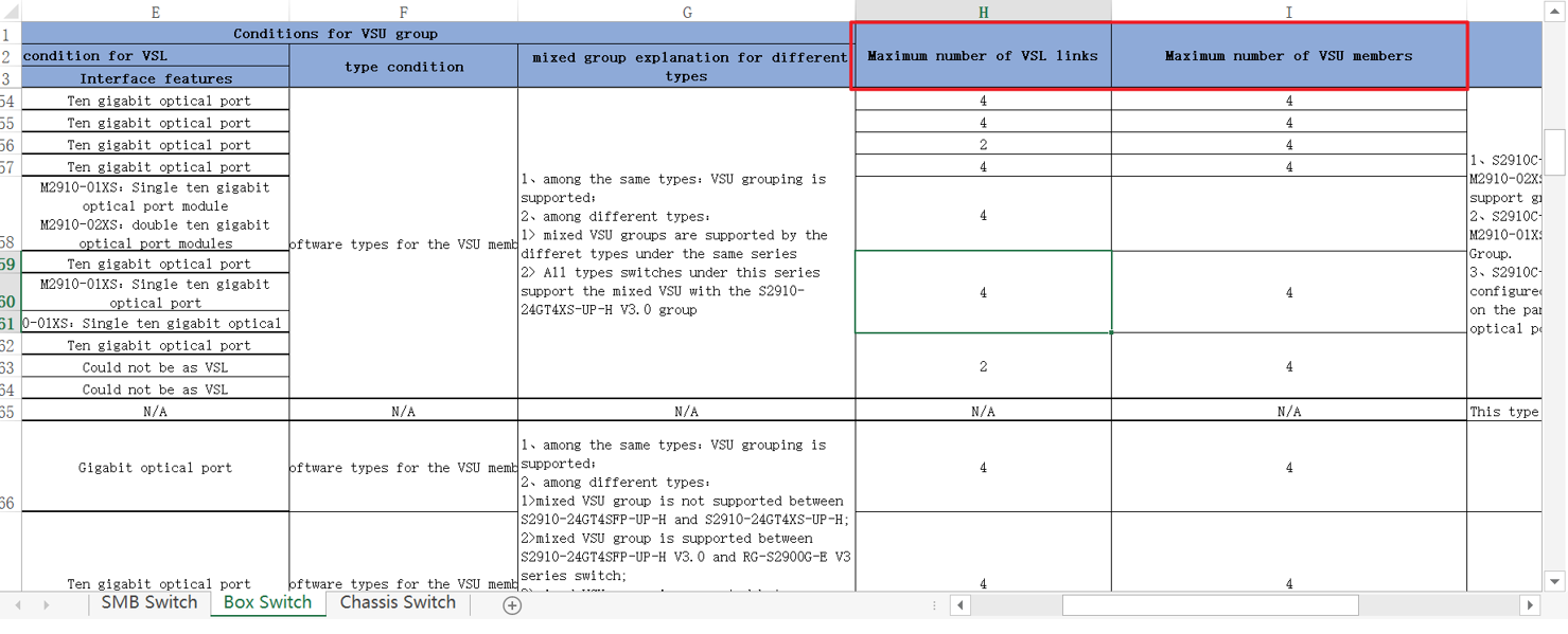

What's the maximum VSL link when switch do the VSU ? Reply
6068 3 2022-11-17 10:50:29
You can refer to Ruijie Switch VSU Limitation to check the maximum number of VSL links and maximum number of VSU members for different models
RG-S5300-24GT4XS-E
Specification Technical Introduction Switch
0 2023-12-12 15:27:58 View all replies

RG-CS86-12XMG4VS-UP and RG-CS86-24XMG4XS4VS-UPD can do VSU together
RG-CS86-24MG4VS-UP and RG-CS86-48MG4VS2QXS-UPD can do VSU together (only 10GE/25GE SFP28 ports and 40GE QSFP+ ports can do VSU
RG-CS86-20XS4VS2QXS-D can only do VSU with RG-CS86-20XS4VS2QXS-D
Jenny
0 2023-12-12 19:39:34 View all replies
Tim Ng replied at 2023-12-12 15:27
Hi, any document about CS series switch?
RG-CS86-12XMG4VS-UP and RG-CS86-24MG4VS-UP up to 4 VSL links and 2 VSU members.
RG-CS86-24XMG4XS4VS-UPD can support up to 8 VSL links and 2 VSU members.
RG-CS86-48MG4VS2QXS-UPD can support up to 6 VSL links and 2 VSU members.
Jenny
