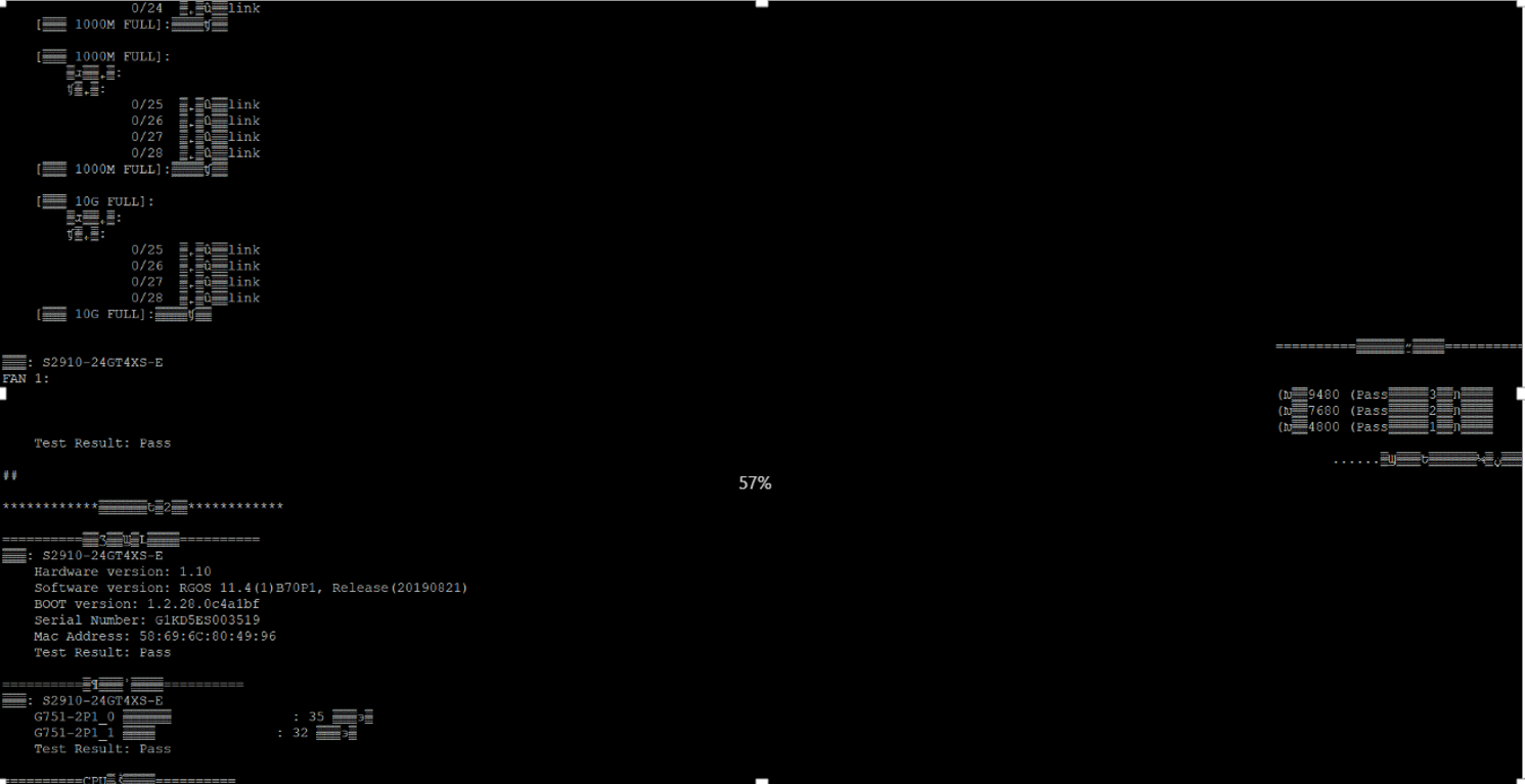

The user interface cannot be accessed After the RG-S2910-24GT4XS-E boot upgrade? Reply
4226 0 2022-11-17 13:43:48
If the interface looks like the following, device is in beta mode.
You can change mode by entering the user modeconfiguration command:
(1) press ctrl+c,enter bootloader memu;
(2)key in“4”, ===》4.scattered utilities.
(3)key in“3”, ===》3. advanced settings.
(4)key in“6”, ===》6. Set RGOS mode.
(5)show :
Switch RGOS to user mode.
Erasing SPI flash...Writing to SPI flash...done
(6)reboot or ctrl + z to enter the first level, select the run 2 main can be restored.
