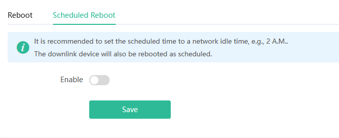

Hi there, im new with the ruijie ecosystem and this is my first ruijie product
Im wondering my router keeps restarting itself, yesterday it happened twice already and today once, im using the power adapter that comes with the router.
Is it normal the normal rebooted itself? i checked for the auto reboot settings in EWeb config is turned off already.
Thank you.

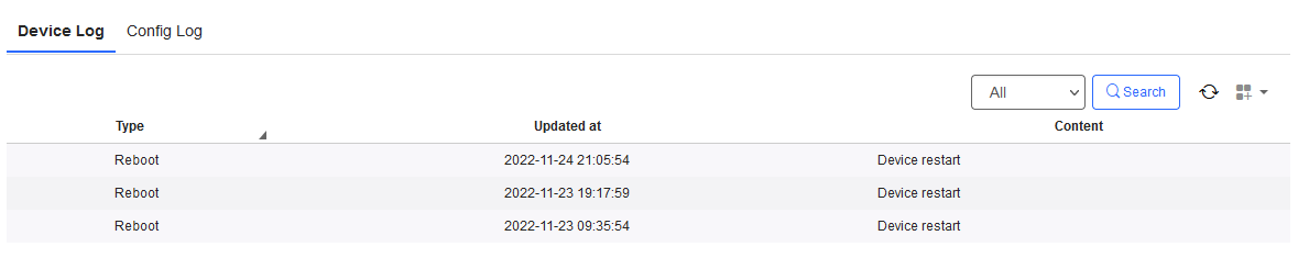

I tried to reset my router (RIP my config i forgot to backup, so backup yours if you going to try this), and it didn't work, still worth trying but it still restarting and it got worse it restarting 5 times that day
Then i checked the power adaptor and sure enough it got corroded and i measure the voltage is 12,6V, so i got it replaced with 12V 2A power adaptor (the original power adaptor is 12V 1.5A), i think the problem is faulty power adaptor and the router didn't get enough amperage? but yeah its been a day without its restarting so thats good
(Device restart in device log it either means it got manually restarted, automatically restarted through the config, or it could be the router lost power)
