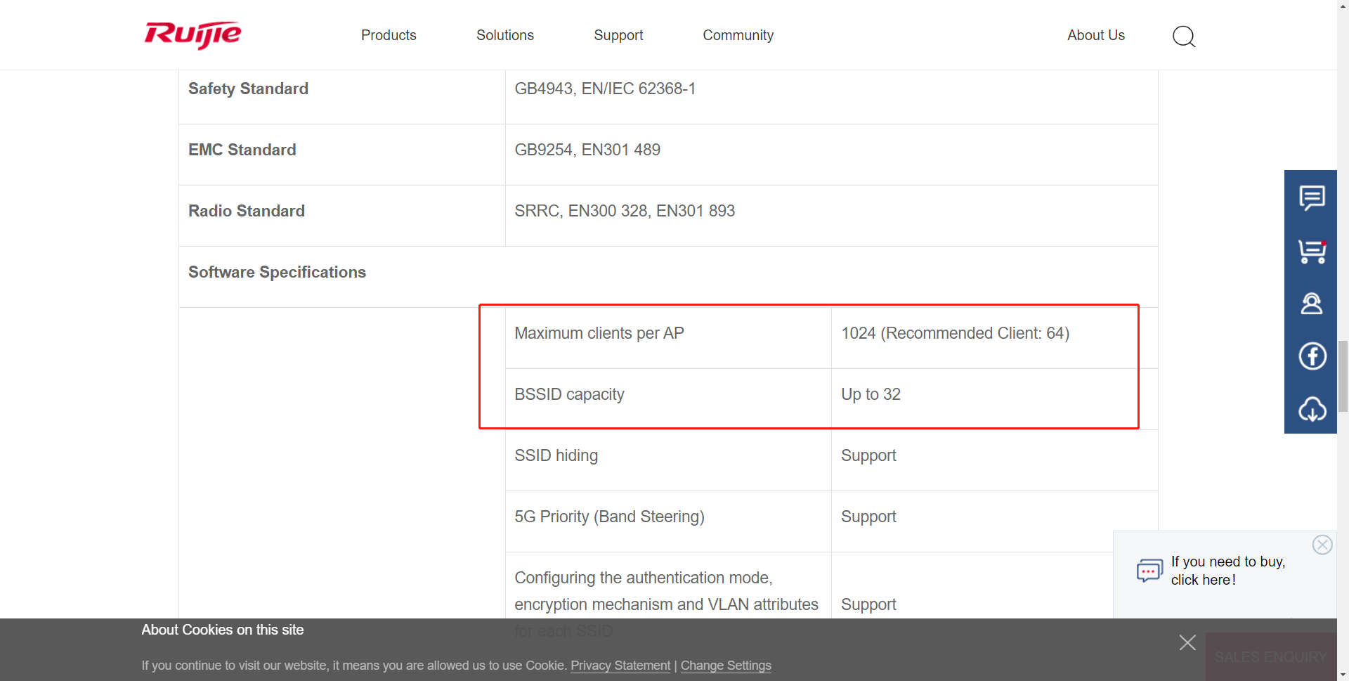

How to set up access point AP-820l (V2) to use concurrent client? Now, if using more than 40 client is very slow in the 5GHz band, but if client are less than 40  will be fast. give me some advice Seen in the specification, up to 1024 client
RG-AP820-L(V2)
0 2022-12-4 16:42:31 Solved View all replies
Dear sir,
Sorry that the Maximum clients per AP is 1024, but t
he recommend clients of AP820-L(V2) is 64 clients(2.4G+5G: 32+32),
https://www.ruijienetworks.com/products/wireless/indoor-access-point-series/rg-ap820-l-v2/specification
0 2022-12-5 13:21:38 View all replies
GTAC-Daisy replied at 2022-12-4 16:42
Dear sir,
Recommended Client: 64.
  Thank
0 2022-12-8 23:03:32 View all replies
Hi Bro,
In case you find any a problem when clients connected with access point was speed bandwidth slow first step please check with envelopment interference signal and please recheck with you configure turn on mu-mimo ,Chanel-Width , and for clients based on data can support up to 1024 STA it's AC Controller mode
