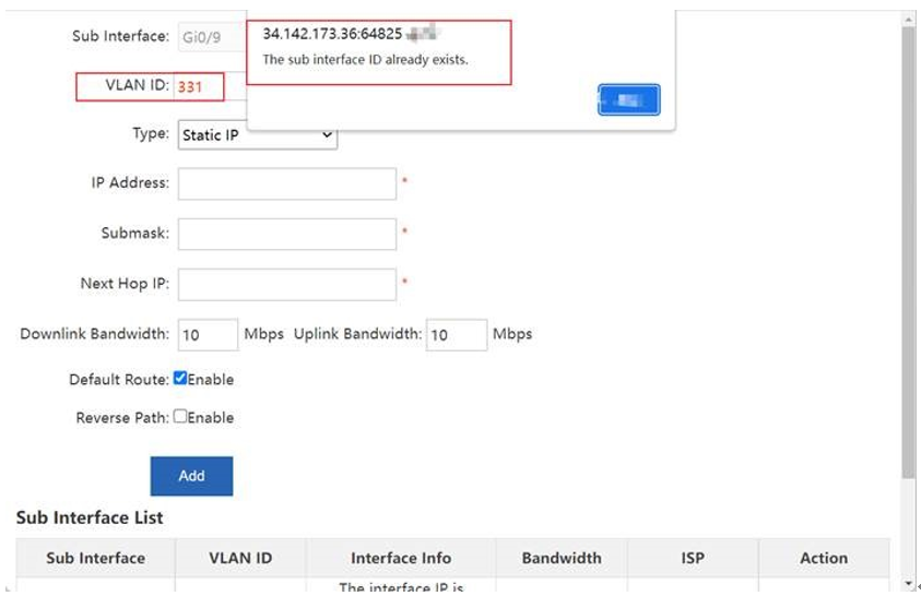

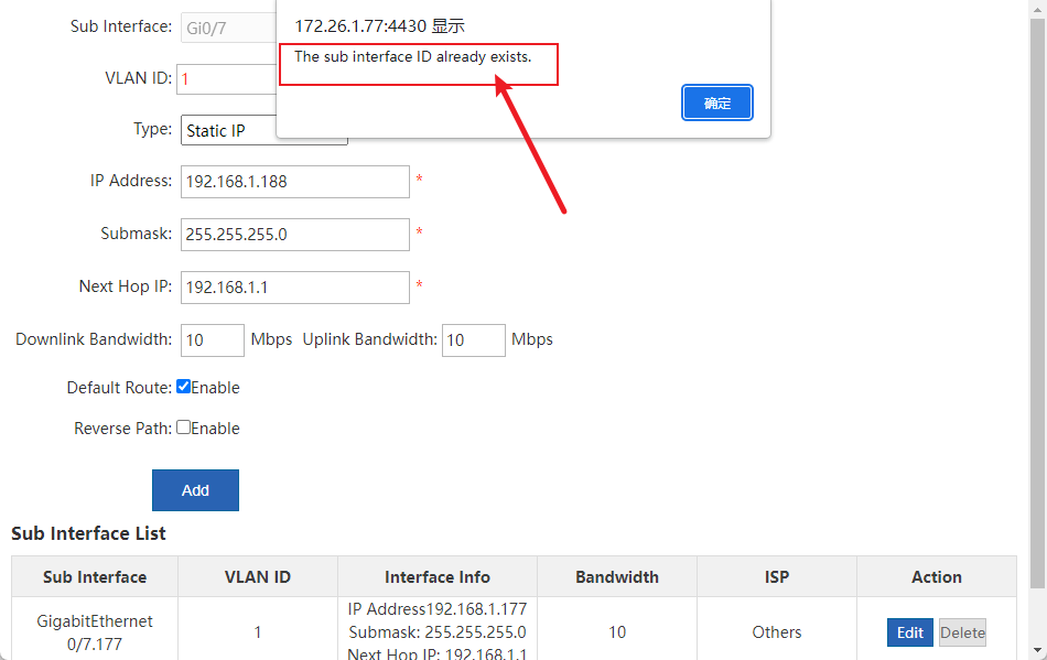

EG3250 cannot set 2 same VLAN ID for 2 WANPPPOE. It will fail if when you use you use the same VLAN ID twice, the notewill be shown as: the VLAN ID already exists:

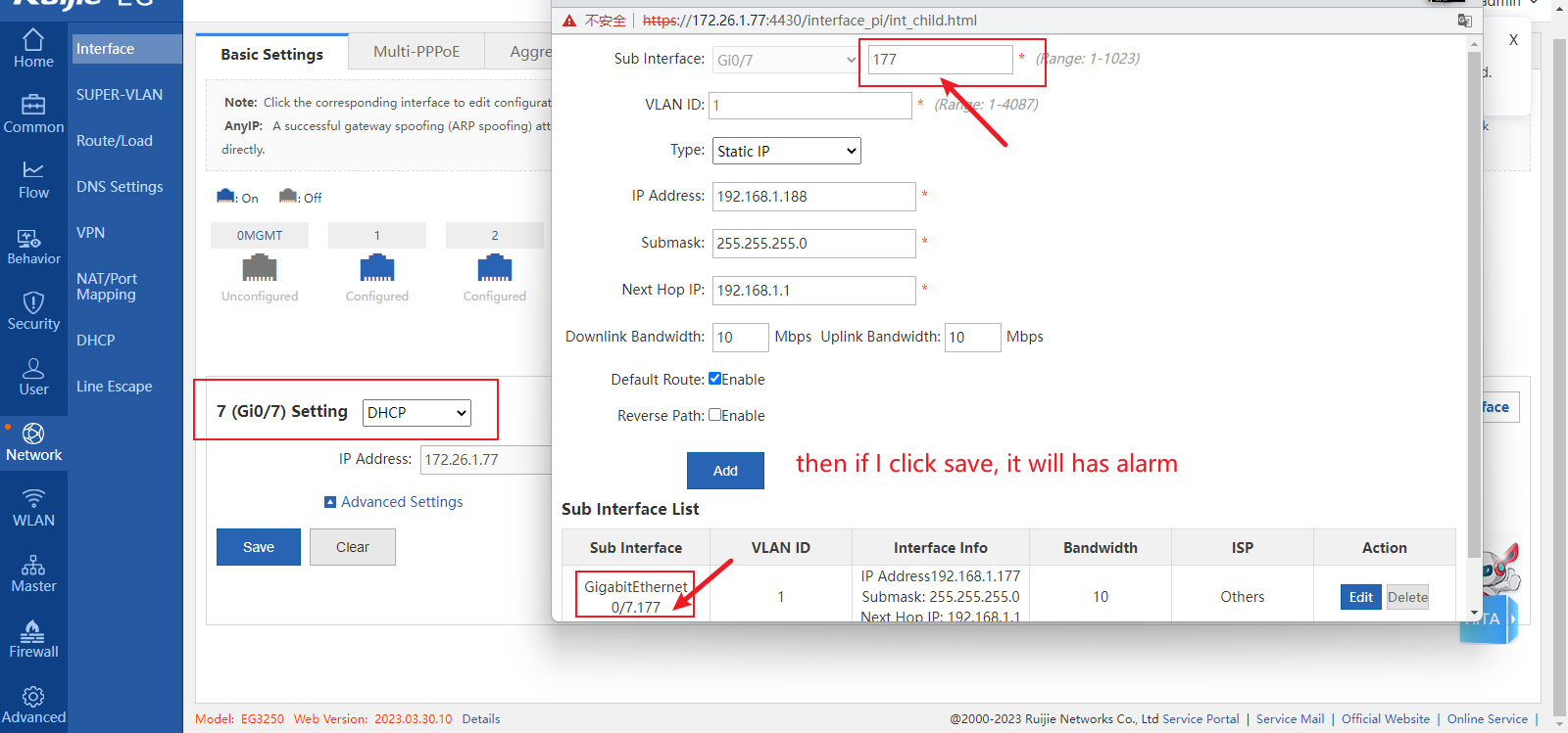

If use DHCP on WAN port, then it will has same limitation with PPPOE, that is cannot set 2 same VLAN ID for 2 WAN
