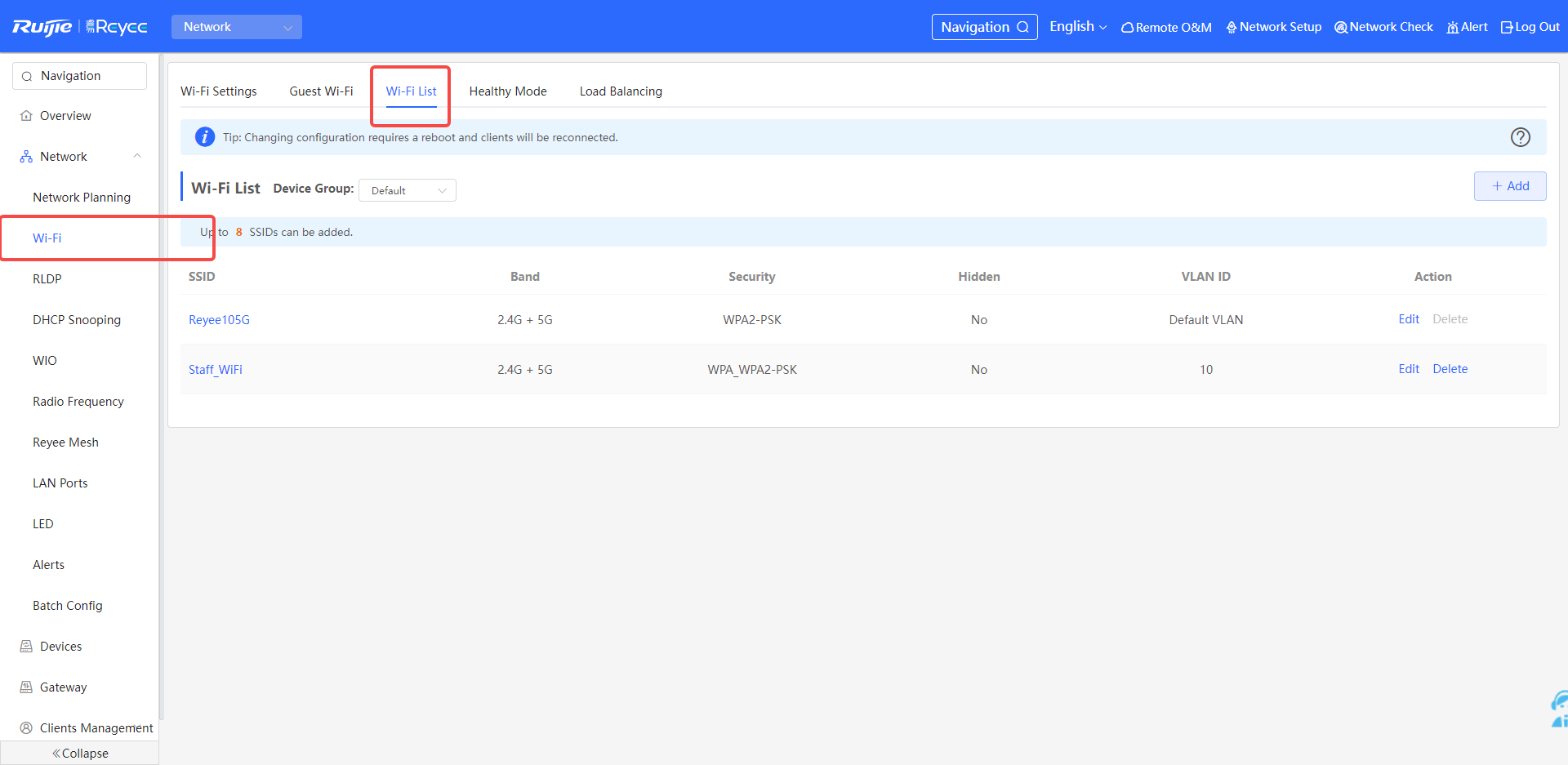

I use Rg-105g-p with 2x rap-2200e, and config mesh between rap-2200e, buat after succesfully create the mesh, then suddenly there is 1 ssid @ruijie*** with open security.
How to delete this ssid as I can't find it on the config?

You can try delete this SSID in Wi-Fi list

I Have check on the list, but there is no @ruijie*** ssid on the list, and this ssid broadcast on the mesh ap only, and when I go to this AP, there is this ssid and it said primary wifi, also said "the slave AP is managed by the master AP and can not be edited locally"
So how to delete this SSID?

Because the AP will be in the same ad hoc network after completing the mesh, this SSID needs to be checked on the Master device
