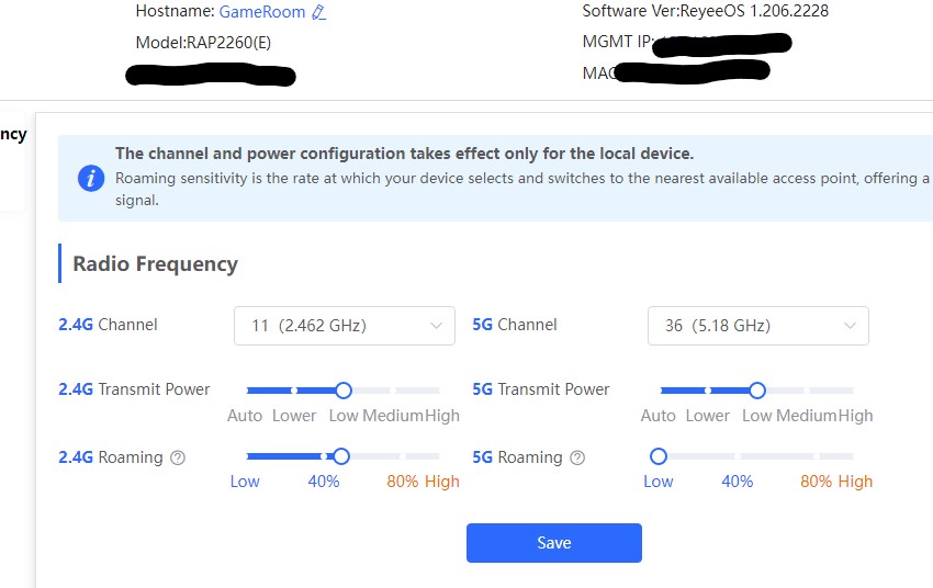

Would you like to share a screenshot of your configuration?
Or you can turn the power of each AP up, depending on your environment.

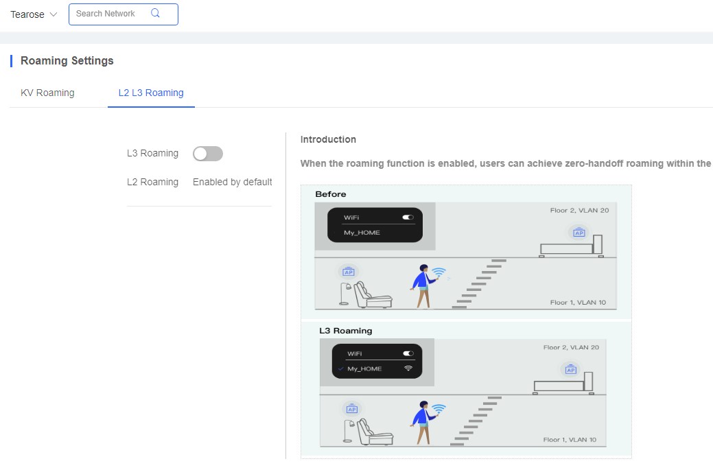

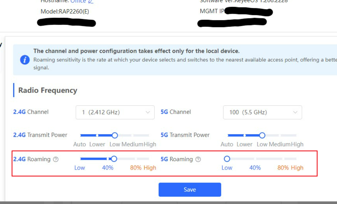

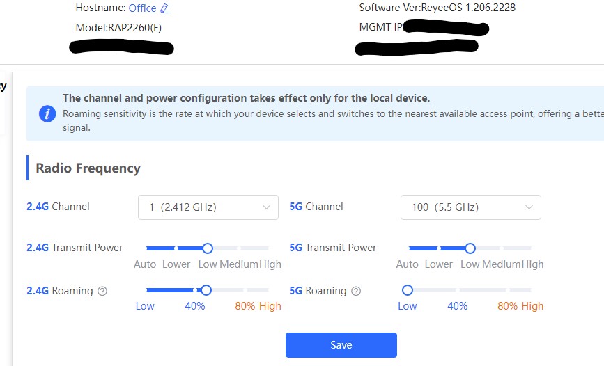

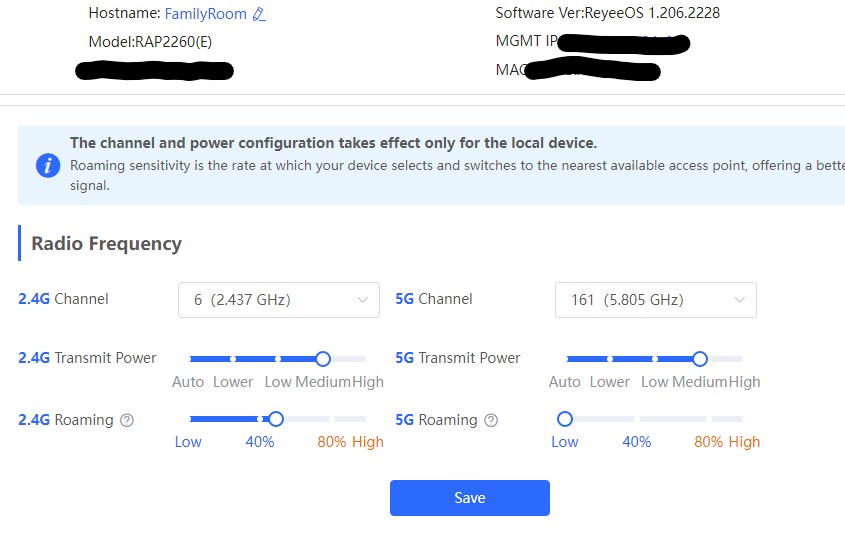

Hello, Please review the screenshots.
0 2022-12-19 15:22:19 View all replies
Mario replied at 2022-12-18 07:24
You can try to increase the sensitivity of roaming then test again.
BTW, may I know whether you want to configure layer 2 or layer 3 roaming?
