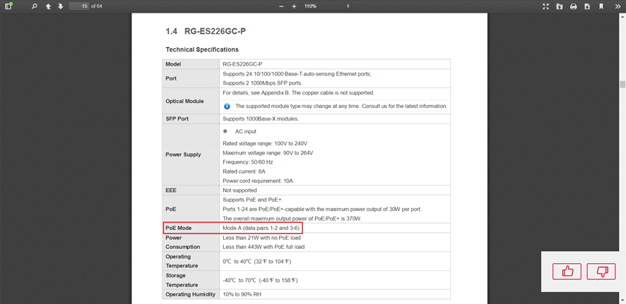

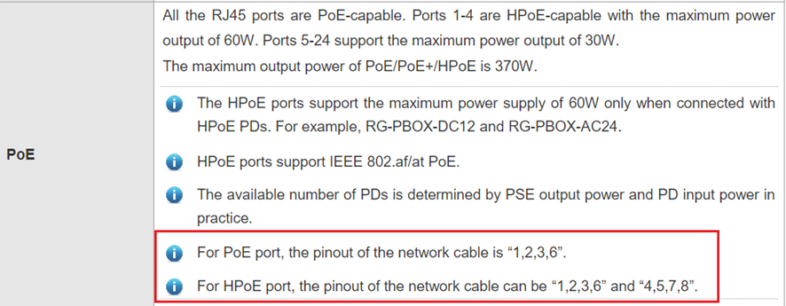

b) Reyee Switch
Example: RG-ES226GC-P
https://www.ruijienetworks.com/resources/preview/76746-Page 5

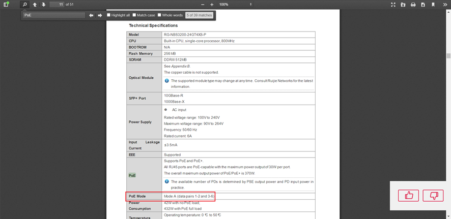

c) RG-NBS3200-24GT4XS-P:
https://www.ruijienetworks.com/resources/preview/76393-Page 11

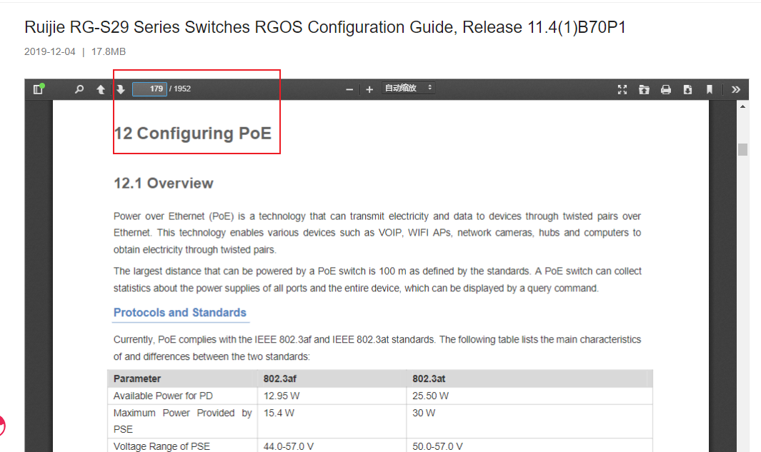

You can refer to page 179 of this link for an introduction to POE:
https://www.ruijienetworks.com/resources/preview/75974
